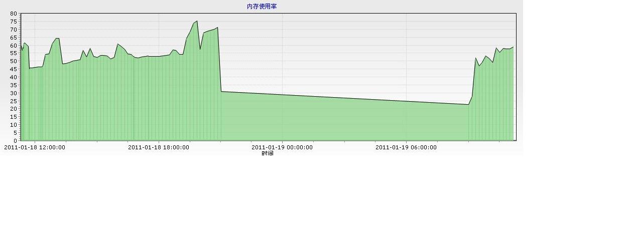

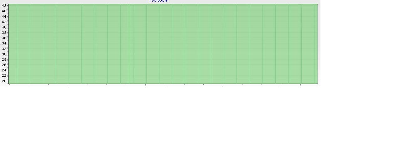

As Described in the Help Doc, We set the AreaLine's Visible property as FALSE, hoped to hide the AreaLine. The Code is as follow:
m_tChart.Series(0).GetAsArea().GetAreaPen().SetVisible(FALSE);
However, the result is not as expected, we can see in the pics follow:

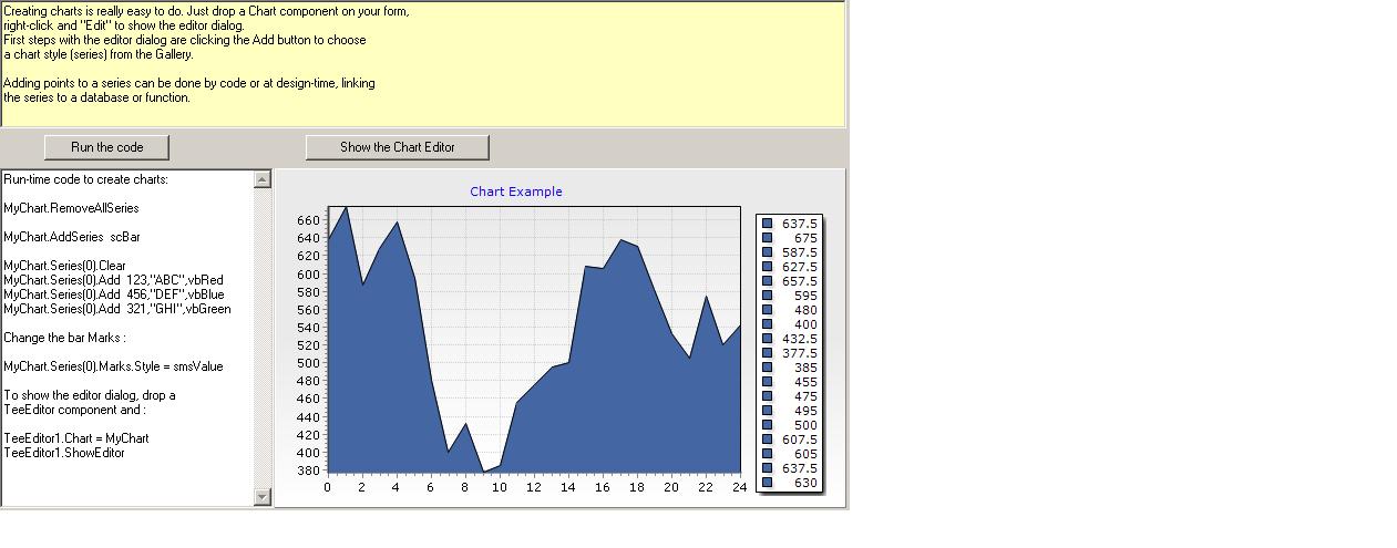

Meanwhile, as we did this job in the feature demo, it works good, as follow:
