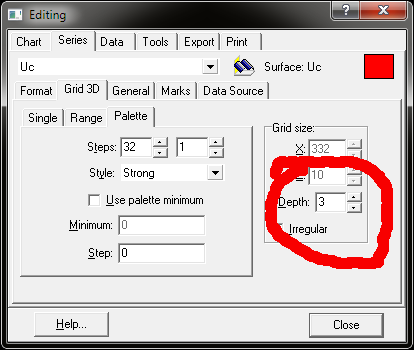

I need to change 3D surface depth (see attachement) by JavaScript and I'm not able to find out how to do it.
Chart1.Series(0).Depth = 21; doesn't work
Please help.

Post by Yeray » Mon Dec 13, 2010 9:11 am
Hi Roman,
I think you are looking for this property:
TChart1.Series(0).asSurface.TimesZOrder = 21

Post by roman » Mon Dec 13, 2010 1:08 pm
Thank you, that is exactly what I've been looking for.
