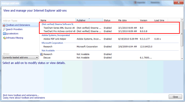

- Check if all components was installed.

Components installation check.

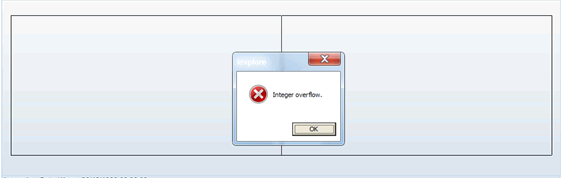

Error starting load method.

Yes, it could be related to regional settings. Note that the decimal separator character is defined in the regional settings. Please, check if your customers have the same decimal separator (check also the ThousandSeparator).
Does a chart without data, or with simplified data load fine in the problematic computers?
