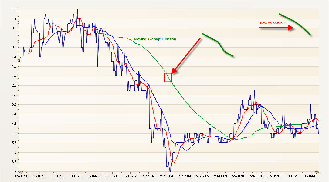

I use some Teechart function based on main serie (like Moving Average). I use the anti-aliasing tools to render.
But the result on moving average is not so good, the result is not a nice curve...How can I obtain a nice moving average curve ? I hope my sample is more clear than my words :D
Thanks for your help,
Guilz

You can add a smoothing function to your chart having the moving average series as source series and make it invisible.
Hope this helps.

I try what you suggest but the result is not fantastic (not a lot difference between smooth serie based on moving average serie and the moving average serie)
changing factor of smooth serie as not a big impact...
Guilz

Take a look at the following example. There is a Point series (source), a moving average function and a smoothing function.
If you zoom in, you'll see how the smoothed function is smoother than the moving average function.
