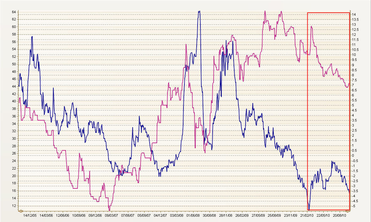

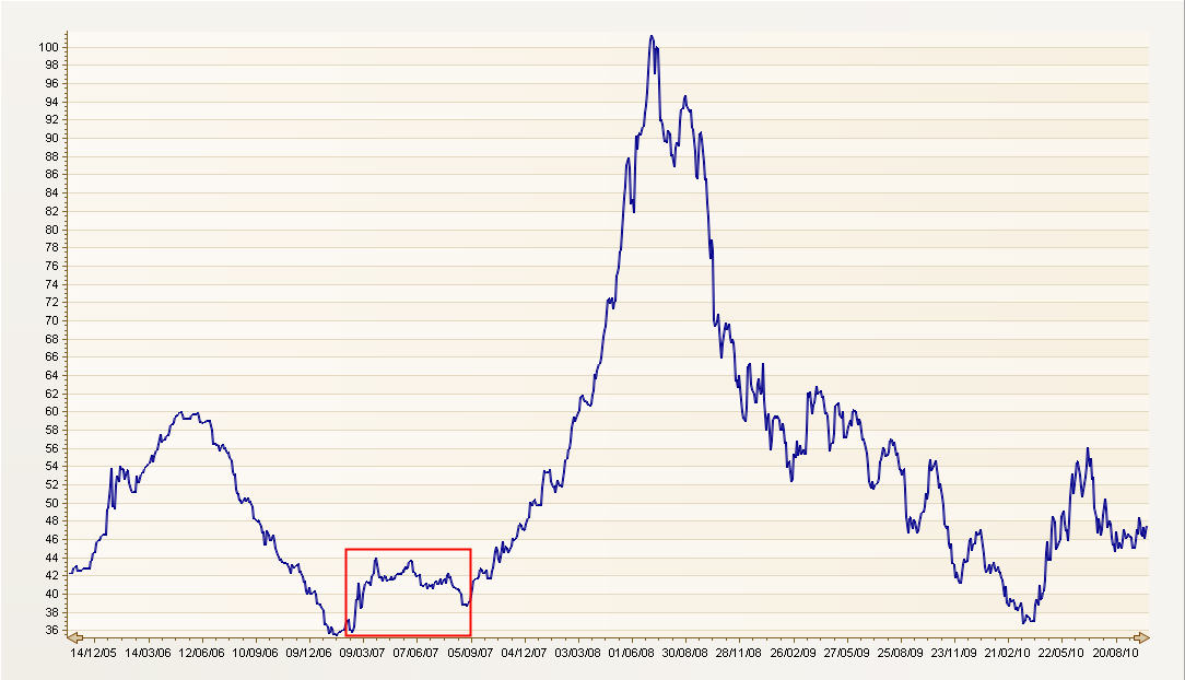

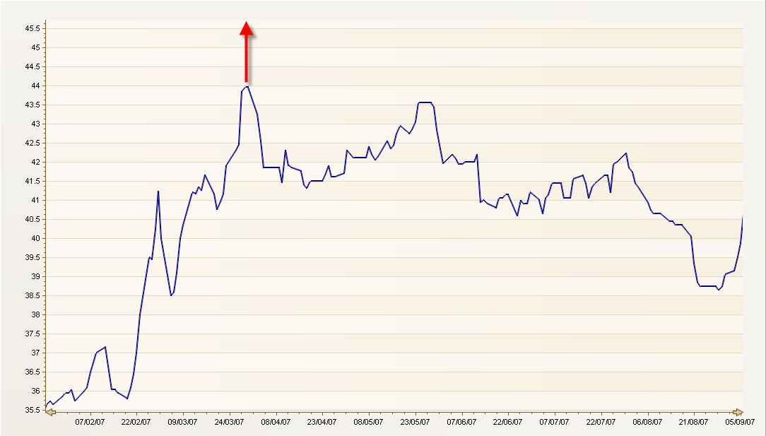

How can I implement a function to find optimal min max axis after zooming ?
I use SetMinMax function but it does not work, the max value of my serie (for current zoom range) is not on the top of the max axis
Private Sub AxTChart_OnZoom(ByVal sender As Object, ByVal e As System.EventArgs) Handles AxTChart.OnZoom
Dim Min As Double
Dim Max As Double
Min = AxTChart.Series(0).MinVisibleValue(1)
Max = AxTChart.Series(0).MaxVisibleValue(1)
AxTChart.Axis.Left.SetMinMax(Min, Max)
Thanks for your help (I did not found any topic about this :D)

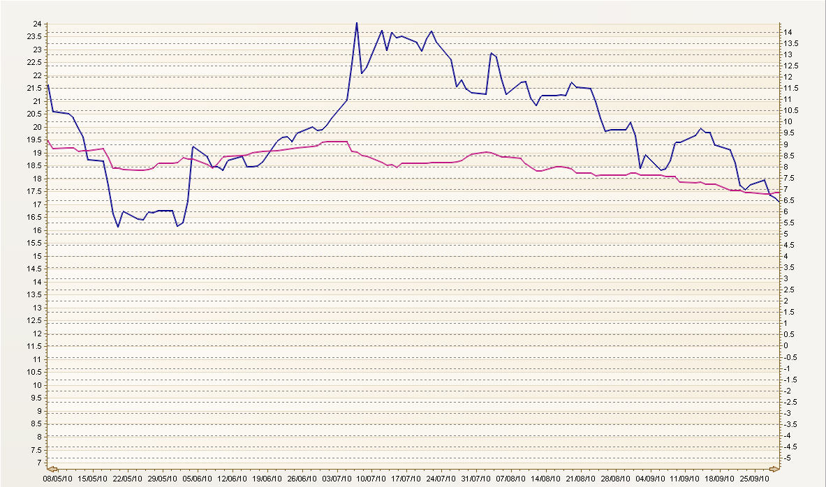

let's consider my new example:
        Dim Min As Double = 99999999
        Dim Max As Double = -99999999
        AxTChart.Environment.InternalRepaint()
        For i = 0 To AxTChart.SeriesCount - 1
            If AxTChart.Series(i).MinVisibleValue(1) < Min Then
                Min = AxTChart.Series(i).MinVisibleValue(1)
            End If
            If AxTChart.Series(i).MaxVisibleValue(1) > Max Then
                Max = AxTChart.Series(i).MaxVisibleValue(1)
            End If
        Next
And the result is not correct as bellow...
How can take in account the left and right axis ?
Thanks for your help...
Guilz
Re: Finding optimal Min Max Axis after zooming
Post by Yeray » Wed Oct 13, 2010 12:48 pm
Hi Guliz,
In that case I'm afraid you should control the full zoom manually as in the example Narcis suggested.
If you find problems with it, don't hesitate to let us know.
