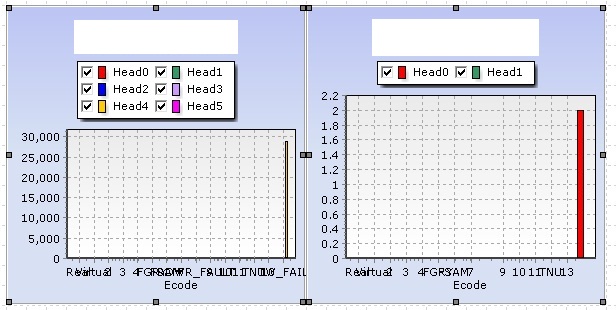

Hi.
I am trying to use Teechart v2101.
When I use line series for Teechart v8.0.0.8, it automatically resizes gap among bottom axis values.
If bottom axis has too many values, it omits displaying a few values and adjusts the gap between values.
But line series for Teechart v2010 displays all values on bottom axis so that I can't recognize it when bottom axis has too many values. SetIncrement() function doesn't also work.
How can I do to resolve this problem?
I am using VS 2008 C++ .NET.
Thank you.
Thank you.

Re: Teechart v2010 dense bottom axis values.
Hi.
Thank you for your answer.
And I'm sorry for late reply.
I have kept on trying to know what problem is.
So, I suggest that you need to make one more series.
I also tested only one series, but I didn't find that problem.
However, when I added two or three series on chart, I could see the problem.
Could you test about that?
Thank you.
Thank you.
