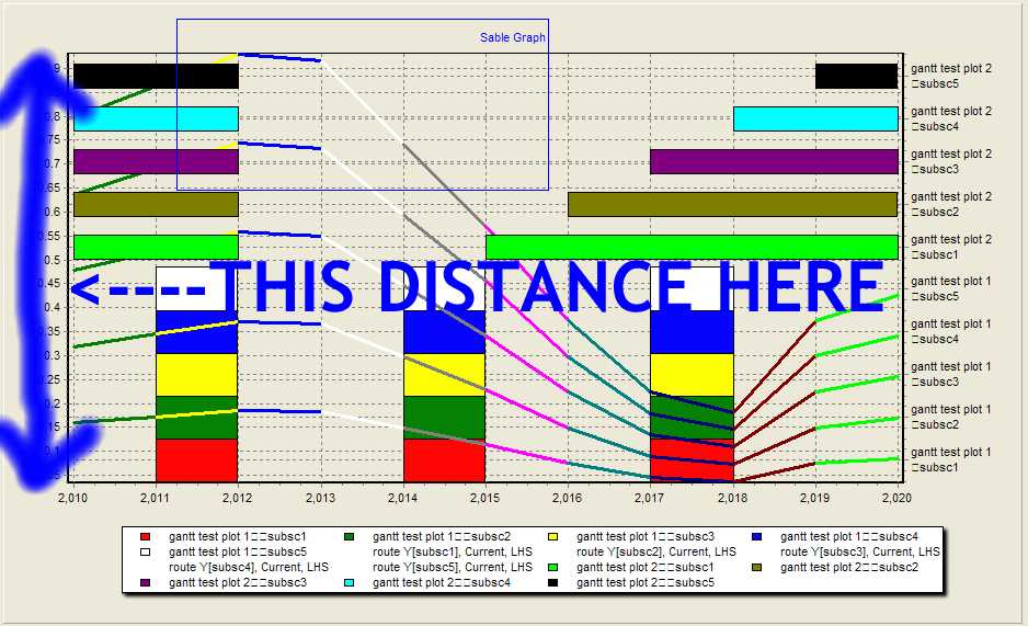

I need to calculate or get the height of the plot area. Is it possible? I've drawn what I need in the attachment.
I've got some Gantt plots, I want to be able to adjust the height of each bar automatically by dividing the plot area by the number of bars. But I cannot work out how to get at the size of the plot area. The Panel class gives the height of the whole TChart window which is not what I need.

Hi Tony,
TChart1.GetChartRect gives you the Rectangle between the axes. The height will be Bottom-Top and the Width is Right-Left.
