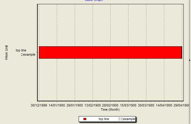

See the attached image.
I selected Axis->Labels->Style->Multi-Line, and then tried setting the x axis label to have two rows.
But I get the strange character. I initially tried sending a Unicode string, then tried a UTF8 string, both have the strange character in it.
Is there any way around this?
- TChart_funny_chars.jpg (17.15 KiB) Viewed 21610 times

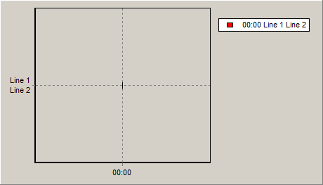

Re: Strange characters in axis labels.
Hi Tony,
We cannot fix it until we can identify it unequivocally reproducing it in a simple application.
Here is my testing C++ application in Visual Studio 2008 with a chart, a commander and a gantt series.
www.steema.us/files/public/support/C++AXTest.zip
Doesn't it work fine for you?

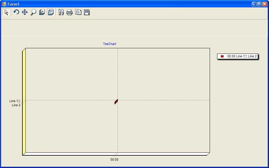

No, this does not work.
I cannot upload the attachment, I get an error "Sorry, the board attachment quota has been reached."
I've uploaded it (the file is called TChart_funny_charsLatest.jpg).
All I did was build the test project and run it.
Let me know if you need anything else.
Tony.
Tony.
Here is the file again.
- TChart_funny_charsLatest.jpg (22.85 KiB) Viewed 21395 times
