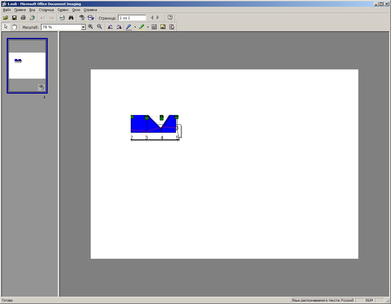

It seems that custom ChartRect coordinates do not add up with the print margins, so the chart is placed in the left-top corner of the page with no regards to margins, which causes chart clipping. I guess I have to add manually print margins to the ChartRect coordinates before printing and subtract them after printing, but I cannot find the correct values.

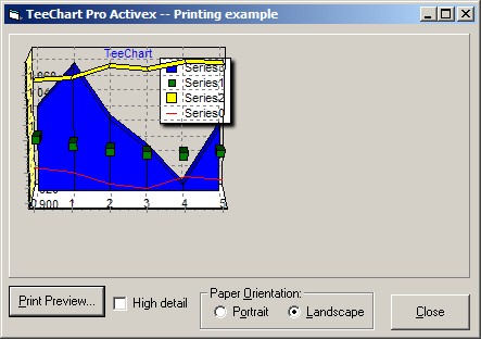

You can easily replicate this issue, by modifing "Examples\Visual Basic\Visual Basic 5 & 6\Printing" by adding to the Form_Load something like
TChart1.CustomChartRect = True
TChart1.ChartRect 10, 10, 210, 160

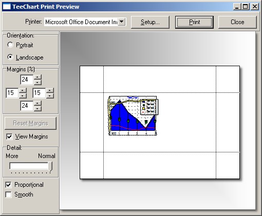

As you can see from attached screenshots, everything looks OK on the print preview page, but the actual print result is incorrect.
