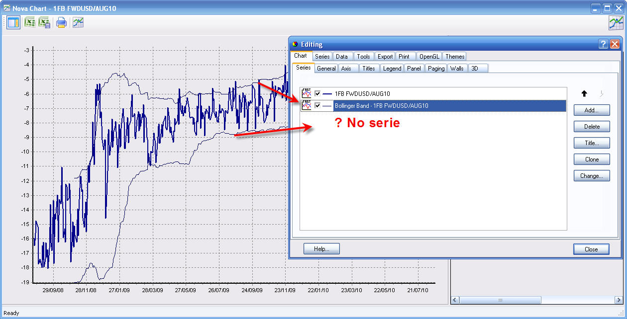

When I used Bollinger function, only 1 serie is added in TeeChart Editor but 2 series are displayed in Chart Control
I would like to have 2 series added in my Teechart editor when I use Bollinger function (1 for upper band and 1 for lower band)...How can I do that ?
Thank you

Hi Guliz,
I've added your request to the wish list to be implemented in future releases (TV52015105).
Right now, it can be done if you know the index of the internal series:
uses StatChar, Series;
var Series1: TFastLineSeries;
    Series2: TFastLineSeries;
    TeeFunction1: TBollingerFunction;
  Chart1.View3D:=false;
  Series1:=Chart1.AddSeries(TFastLineSeries) as TFastLineSeries;
  Series1.Pen.Width:=2;
  Series1.FillSampleValues(100);
  Series2:=Chart1.AddSeries(TFastLineSeries) as TFastLineSeries;
  TeeFunction1:=TBollingerFunction.Create(self);
  Series2.FunctionType:=TeeFunction1;
  Series2.DataSource:=Series1;
  Chart1[Chart1.SeriesCount-1].ShowInEditor:=true;
  Chart1[Chart1.SeriesCount-1].ShowInLegend:=true;

You're right - the ShowInEditor method solve this issue...waiting the next release :D
Thank you !
