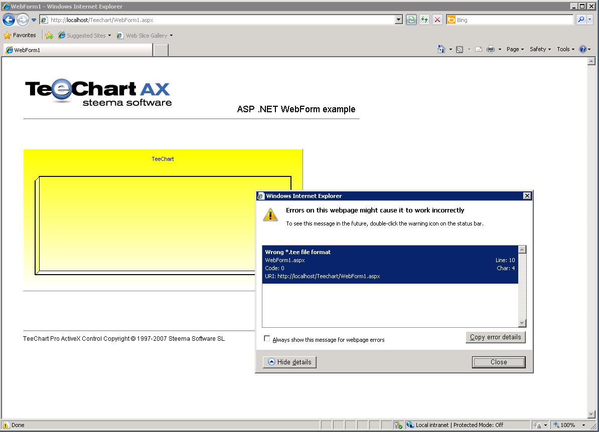

I tried to use our website with a Teechart on it to use on Windows 2008 R2 Server (64 bit).
Our current website currently works with Teechart version 7.0.1.4.
This works fine with Windows XP, Windows 2003 Server and Windows 2008 Server (32 bit).
When I try to use our website on a 64 bit Windows 2008 R2 server I get everytime the error "Wrong *.tee file format".
After testing our website I installed Teechart v8008Eval version on our server.
When I try to view the sample website from Teechart I get the same error: (See attached screenshot).
Has anyone a solution for this?
Or is it not possible to use the Teechart on the 64 bits Windows 2008 Server?

I'm having this problem using TeeChart8 and Windows 2008 R2. Any solutions to this problem?

I'm attempting to view the sample ASP pages (the ones that install with TeeChart 8). I'm using the 64-bit version of Windows Server 2008 R2, could the problem be related to the 64-bit OS? Are there any installation instructions for Windows Server 2008 R2, maybe I missed a step?
