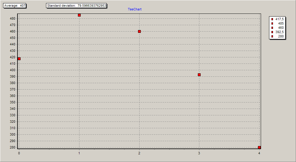

The example above gives me the following result:
Doesn't it give the same result to you? What exact TeeChart version are you using? Is it the latest available in the client area?
