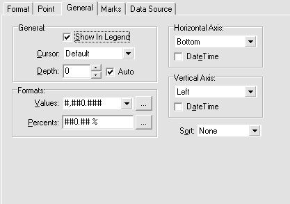

Hello all,
Is it possible to embed the series format panel into another dialog?
What I want to so is have the panel below (Format, Point, General and Marks (I don't want "data source")) in my own dialog so a user can format the series.

Yes, I use the chart editor already.
But I would like to be able to just give the user formatting options for a particular series (so not even let them select the series). All I really want them to see is "format", "point", "general" and "marks", is there any way of doing this?

I've added it to the wish list to be implemented in future releases (TA05015048). In the meanwhile I'm afraid you should create your custom dialog adding the functionalities you want to it.TonyVSUK wrote:But I would like to be able to just give the user formatting options for a particular series (so not even let them select the series). All I really want them to see is "format", "point", "general" and "marks", is there any way of doing this?
