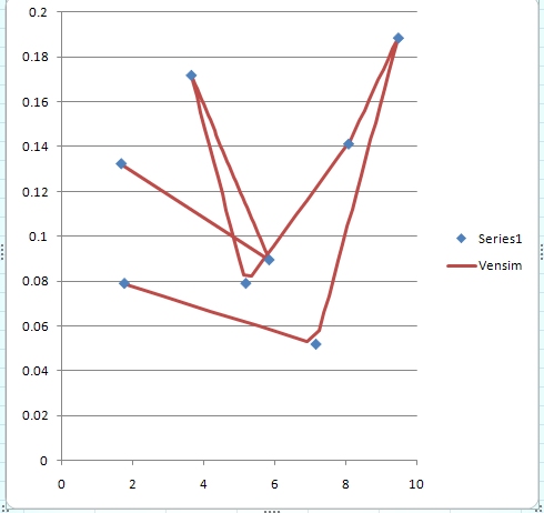

I tried that. What I'm trying to show is a kind of flight plan, similar to the attached image.
- ExcelSample.jpg (47.28 KiB) Viewed 9708 times

Re: Point series: Is it possible to join the points with a line?
Hi Tony,
In that case you should use line series with visible pointers and set XValues.Order to none before populating values. By default it's set to ascending.

I think I've figured out how to set the order.
I've been using AddXY with the line series, should I be using a different function?
The code for testing I have is below. It adds two series, one point, one line. The resultant graph should be identical to the Excel one.
Got it working now. Many thanks. I just needed to set the order to none on both X and Y.
Tony.
TChart1.Series(1).YValues.Order = loNone
TChart1.Series(1).XValues.Order = loNone
Hi Tony,
You're welcome. It's not necessary setting YValues.Order as by default it's none already.
