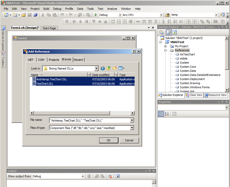

Regarding the VisualStudio projects, you should use the strong named dlls on them (AxInterop.TeeChart.dll and Interop.TeeChart.dll), not directly the ocx. You should find them at:
"C:\Program Files\TeeChart Pro v5 ActiveX Control\Utilities\VS.NET\Strong Named DLLs"
"C:\Program Files\Steema Software\TeeChart Pro v8 ActiveX Evaluation\Examples\Visual Studio .NET\CSharp\Dragging\obj\"
Bruce.McDowall wrote:1. Should TeeChart5 ActiveX work with Windows 7?
Yes, it works.
Bruce.McDowall wrote:2. How do I add a reference to AxTeeChart in VS2008 to VB.NET?
In the "Solution Explorer", right click on "References" (with "Show All files" selected) and go to "Add Reference...". Then, browse to the dlls:

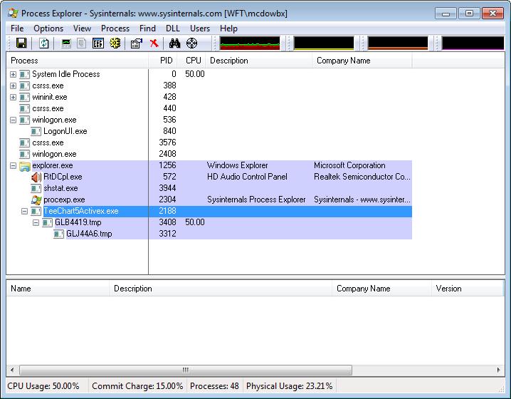

I copied the 5.0.6 example from my development PC to a deployment PC. The example does not display a window but remains in the task/process list.
I tried to install TeeChart ActiveX 5.0.6 on the deployment PC but the installation hangs and appears to be active in the task/process list. If it is killed then the uninstall fails.
TeeChart installation hanging.JPG (4.01 KiB) Viewed 8813 times
TeeChart installation procex.JPG (65.39 KiB) Viewed 8838 times
This is a Windows 7 Enterprise system and the user has administrator rights.
I would rather resolve this problem as we have no need to move to 8 at the moment.
