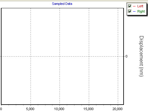

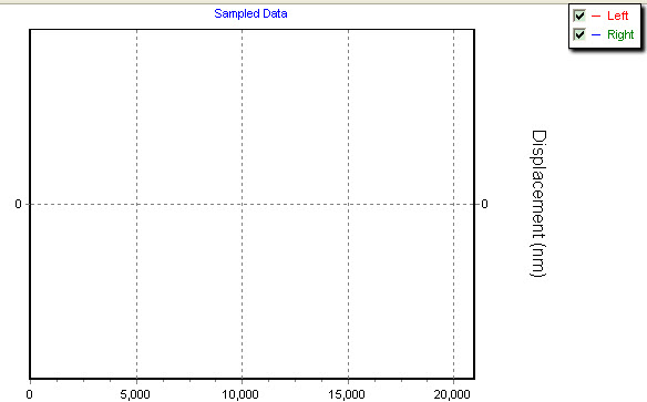

How can I adjust the legend position so that it won't waste the plotting area? legend1.jpg is what the teechart's default legend position, and legend2.jpg is what I want to realize. Would anyone please advice how to do it? Thanks.

You should adjust the legend manually doing something like this:
Private Sub AdjustLegend()
  Dim tmpWidth, tmpMargin As Integer
  tmpWidth = TChart1.Legend.ShapeBounds.Right - TChart1.Legend.ShapeBounds.Left
  tmpMargin = 10
  TChart1.Legend.CustomPosition = True
  TChart1.Panel.MarginUnits = muPixels
  TChart1.Panel.MarginRight = tmpWidth + tmpMargin * 2
  TChart1.Legend.Left = TChart1.ChartBounds.Right - tmpWidth - tmpMargin
  AdjustLegend

Hi David,
With the following changes it seems to work fine here.
The problem is that you set a right axis title, so the calculations made before didn't consider the margin added automatically for this text.
BOOL CChartLegendTestDlg::OnInitDialog()
	m_chart1.GetAspect().SetView3D(FALSE);
	m_chart1.AddSeries(scFastLine);
	m_chart1.Series(1).SetVerticalAxis(aRightAxis);
	m_chart1.GetAxis().GetRight().GetTitle().SetCaption("Test");
	m_chart1.GetAxis().GetRight().GetLabels().SetSize(42);
	m_chart1.GetAxis().GetRight().GetTitle().GetFont().SetSize(12);
	m_chart1.GetAxis().GetRight().SetAutomatic(TRUE);
	m_chart1.GetLegend().SetCustomPosition(TRUE);
	m_chart1.GetEnvironment().InternalRepaint();
	return TRUE;
void CChartLegendTestDlg::OnAfterDrawTchart1()
	int nWidth = m_chart1.GetLegend().GetShapeBounds().GetRight()-m_chart1.GetLegend().GetShapeBounds().GetLeft();
	int nMgn = 10;
	int axisMgn = 65;
	m_chart1.GetPanel().SetMarginUnits(muPixels);
	m_chart1.GetPanel().SetMarginRight(nWidth - axisMgn + nMgn*2);
	m_chart1.GetLegend().SetLeft(m_chart1.GetAxis().GetBottom().GetIEndPos() + nMgn);
