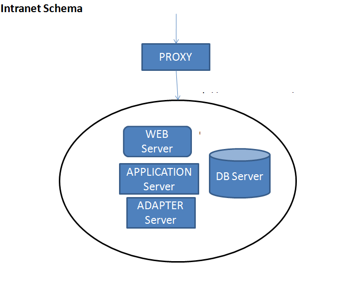

we are using the teeChart active x version 7.0.1.3.
when we are using it in a normal environment it works fine, but when using it under a proxy server we get the following error "Stream read error".
please see the attached image that describe the topology of the system that the error is thrown.
can you please help us understanding why we get the error?

Hi Ron,
Have you checked that the proxy's permissions allow to execute scripts through it? It probably has to be related to permission issues.
