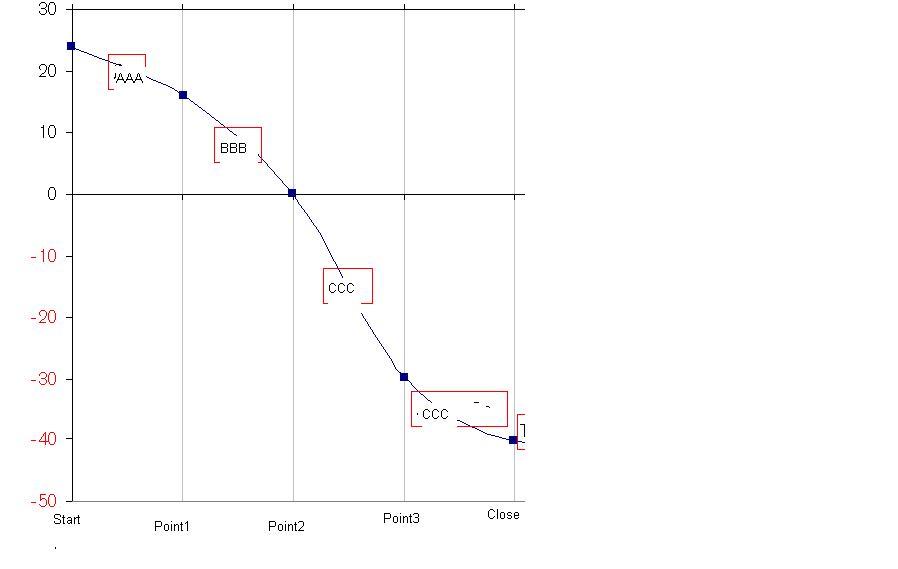

I need to get two things in my Line graph. Attached is a sample to show what I am looking for.
1. Is it possible to have label in between the points? In my eg:- lables like "AAA","BBB" etc.
2. To have labels in my X-axis (I need to put text as labels). In my eg: - "Start","Point1","Point2" etc.
If I add using Chart.Series(0).Add 20, "AAA", RGB(0, 64, 128) Then "AAA" comes near the point.
I was able to do the 2nd requirement using .Axis.Bottom.labels.Style = talMark.
I need a combination of points 1 and 2.
Can you tell me what settings I need to do to set this.
Any help on this will be really helpfull.

- This is what I am looking for.
- DifferentLabelsInAxis.JPG (24.9 KiB) Viewed 17294 times

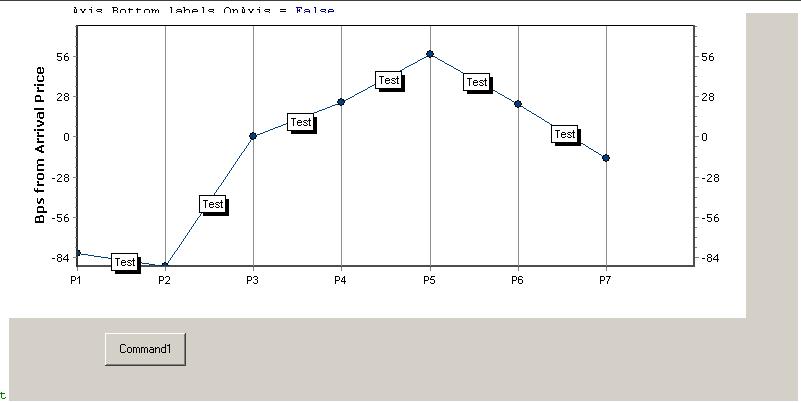

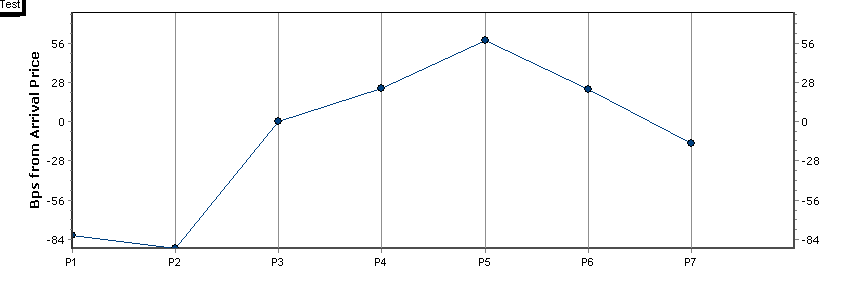

Re: Labels in between points in line chart
I tried to use Annotation but I am not able to plot Annotation in the middle of the points.
It works fine when I run the cod eand view the output but when I Export that image to jpeg the points are not on the same Location.
Also I have attached both the screenshot.
Following is Code whcih I am using for Graph generation :

.Text = "Test"
.Shape.Left = ((TChart1.Series(0).CalcXPos(i + 1) - TChart1.Series(0).CalcXPos(i)) / 2) + TChart1.Series(0).CalcXPos(i) - (TChart1.Canvas.TextWidth(.Text) / 2)
.Shape.Top = ((TChart1.Series(0).CalcYPos(i + 1) - TChart1.Series(0).CalcYPos(i)) / 2) + TChart1.Series(0).CalcYPos(i) - (TChart1.Canvas.TextHeight(.Text) / 2)
.Shape.Transparent = False
End With
Next i
Private Sub Command1_Click()
With TChart1.Export.asGIF
.Width = 850
.Height = 300
.SaveToFile ("C:\Test.gif")
End With
Private Sub Form_Load()
TChart1.ClearChart
With TChart1
.AddSeries (scLine)
.Series(0).Clear
'.Series(0).Marks.Visible = True
.Panel.Color = vbWhite
.Panel.BevelOuter = bvNone
.Panel.Gradient.Visible = False
.Header.Text.Clear
'.Header.Text.Add m_sHeader
.Header.Font.Color = vbRed
.Header.Font.Bold = False
.Header.Font.Name = "Verdana"
.Header.Font.Size = 8
.Tools.Clear
.Footer.Text.Clear
.Footer.Text.Add m_sFooter
.Legend.Visible = False
.Legend.TextStyle = ltsLeftValue
.Legend.Font.Color = vbBlack
.Legend.Font.Name = "Verdana"
.Legend.Font.Size = 8
.Legend.ShapeStyle = fosRoundRectangle
.Legend.ShadowSize = 0
.Walls.Visible = False
.Aspect.View3D = False
.Axis.Left.Title.Caption = "Bps from Arrival Price"
.Axis.Left.Title.Font.Bold = True
.Axis.Left.Title.Font.Name = "Verdana"
.Axis.Left.Title.Font.Size = 10
.Axis.Left.Title.Font.Color = vbBlack
.Axis.Left.AxisPen.Color = RGB(51, 51, 51)
.Axis.Left.labels.Font.Color = vbBlack
.Axis.Left.labels.Font.Name = "Verdana"
.Axis.Left.labels.Font.Size = 8
.Axis.Left.labels.Font.Bold = False
.Axis.Left.GridPen.Visible = False
.Axis.Bottom.AxisPen.Color = RGB(77, 77, 77)
.Axis.Bottom.labels.Font.Name = "Verdana"
.Axis.Bottom.labels.Font.Size = 8
.Axis.Bottom.labels.Font.Color = vbWhite
.Axis.Bottom.labels.OnAxis = False
.Axis.Bottom.Title.Caption = m_sXAxisTitle
.Axis.Bottom.Title.Font.Bold = False
.Axis.Bottom.Title.Font.Color = vbBlack
.Axis.Bottom.GridPen.Visible = True
.Axis.Bottom.GridPen.Style = psSolid
.Axis.Bottom.GridPen.Color = RGB(143, 143, 143)
.Axis.Right.Visible = True
.Axis.Right.AxisPen.Color = RGB(77, 77, 77)
.Axis.Right.labels.Font.Name = "Verdana"
.Axis.Right.labels.Font.Size = 8
.Axis.Right.Title.Caption = m_sXAxisTitle
.Axis.Right.Title.Font.Bold = False
.Axis.Right.Title.Font.Color = vbBlack
.Axis.Right.GridPen.Visible = False
.Axis.Top.Visible = False
.Axis.Top.AxisPen.Color = RGB(77, 77, 77)
.Axis.Top.labels.Visible = False
End With
'TChart1.Aspect.View3D = False
'TChart1.ClearChart
TChart1.AddSeries scLine
TChart1.Series(0).asLine.Pointer.Visible = True
m_lMinLeftAxis = 0
m_lMaxLeftAxis = 0
Dim Point1, Point2, Point3, Point4, Point4TPlusOne, Point4TPlusFive
Dim zeroCorrectingFigure, tmpNumber
tmpNumber = 0
zeroCorrectingFigure = 0
With TChart1
Dim points, labels, i, calcMethodType, CalcCol
.Series(0).asLine.LinePen.Width = 1
.Series(0).asLine.LinePen.Style = psSolid
.Series(0).asLine.LinePen.EndStyle = esFlat
.Axis.Bottom.labels.Visible = True
.Axis.Bottom.labels.Font.Name = "Arial"
.Axis.Bottom.labels.OnAxis = True
.Axis.Bottom.labels.Font.Color = vbBlack
.Axis.Bottom.labels.Style = talText
.Axis.Bottom.MinorTicks.Visible = False
Point1 = -81.11
Point2 = -90.45
Point3 = 23.9
Point4 = 57.87
Point4TPlusOne = 22.88
Point4TPlusFive = -15.23
.Series(0).Add Round(Point1, 2), "P1", RGB(0, 64, 128)
If m_lMinLeftAxis > Point1 Then m_lMinLeftAxis = Point1
If m_lMaxLeftAxis < Point1 Then m_lMaxLeftAxis = Point1
m_lMaxBottomAxis = m_lMaxBottomAxis + 1
.Series(0).Add Round(Point2, 2), "P2", RGB(0, 64, 128)
If m_lMinLeftAxis > Point2 Then m_lMinLeftAxis = Point2
If m_lMaxLeftAxis < Point2 Then m_lMaxLeftAxis = Point2
.Series(0).Add 0, "P3", RGB(0, 64, 128)
.Series(0).Add Round(Point3, 2), "P4", RGB(0, 64, 128)
If m_lMinLeftAxis > Point3 Then m_lMinLeftAxis = Point3
If m_lMaxLeftAxis < Point3 Then m_lMaxLeftAxis = Point3
.Series(0).Add Round(Point4, 2), "P5", RGB(0, 64, 128)
If m_lMinLeftAxis > Point4 Then m_lMinLeftAxis = Point4
If m_lMaxLeftAxis < Point4 Then m_lMaxLeftAxis = Point4
.Series(0).Add Round(Point4TPlusOne, 2), "P6", RGB(0, 64, 128)
If m_lMinLeftAxis > Point4TPlusOne Then m_lMinLeftAxis = Point4TPlusOne
If m_lMaxLeftAxis < Point4TPlusOne Then m_lMaxLeftAxis = Point4TPlusOne
.Series(0).Add Round(Point4TPlusFive, 2), "P7", RGB(0, 64, 128)
If m_lMinLeftAxis > Point4TPlusFive Then m_lMinLeftAxis = Point4TPlusFive
If m_lMaxLeftAxis < Point4TPlusFive Then m_lMaxLeftAxis = Point4TPlusFive
.Series(0).VerticalAxis = aBothVertAxis
.Series(0).asLine.Pointer.Style = psCircle
With .Axis.Left
.SetMinMax m_lMinLeftAxis, m_lMaxLeftAxis + 20
If (((m_lMaxLeftAxis + 20) - (m_lMinLeftAxis - 5)) / 6) > 0 Then
.Increment = Int(((m_lMaxLeftAxis + 20) - (m_lMinLeftAxis - 5)) / 6)
End If
End With
With .Axis.Bottom
.SetMinMax 0, m_lMaxBottomAxis
End With
With .Axis.Right
End If
End With
End With
For i = 0 To TChart1.Series(0).Count - 2
TChart1.Tools.Add tcAnnotate
With TChart1.Tools.Items(i).asAnnotation
.Text = "Test"
End With
Next i
Hi CS,
You could try exporting the chart to an image using TChart1.Canvas.StretchDraw method.
I am using TChart Version 5 in Visual Basis.
I can't find StretchDraw Method in this version.
Can you give me some other solution to fix this.
CS
CS
- Site Admin
- Posts: 14730
- Contact:
Hi CS,
StretchDraw is available in v2010 (aka v9). Many new features and enhancements have been added since v5 was released. We strongly recommend you to have a look at v2010's fully functional evaluation version available at http://www.steema.com/evaluation/ax.
An alternative to StretchDraw, which can be done in v5 too is positioning object in the OnBeforeDrawSeries event. Doing so exports tools correctly. You should remove the code where you add tools and do something like this:
Private Sub TChart1_OnBeforeDrawSeries()
TChart1.Tools.Clear
.Text = "Test"
.Shape.CustomPosition = True
End With
Next i
