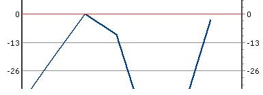

In Attached files what I am getting is "NotSmooth.jpg"

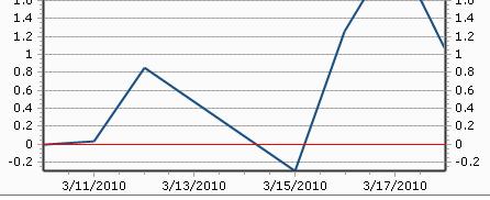

What I need is "SmoothOne_Sample.JPG"

- What I need. In this one the lines are smooth.

- What I am getting. In this line is not smooth.

Re: Line is not smooth.
Hi CS,
If you are trying to export a chart with antialias tool, as seb said, this is a known problem already in the defect list (TV52013668).
I recommend you to be aware at this forum or subscribe to our RSS news feed for new release announcements and what's implemented on them.
