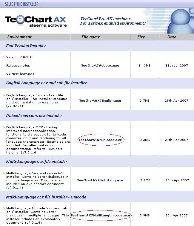

Post by Narcís » Fri Dec 18, 2009 8:07 am
Hi cwdave,
I'm sorry but I can not post product direct download links in a public forum. Anyway, I can see unicode version installers in TeeChart Pro v7 ActiveX download page. They are right below the standard and English installers as you can see in the image below.
