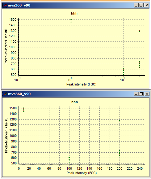

I tried using the "IAxisLabels.Exponent" set to TRUE to get exponent super scripts using the ValueFormat of "00e-0".
It looks real nice, but the tick labels are wrong. When I plot linear the ticks line up with my data just right. The when I change to a log scale and this formating the values displayed are "10 with superscript of 0" for the 100s tick, for the 1000s I get "10 with a superscript of 1"
I've upload an image
- Log Axis Labels wrong
- LogAxisLabelError.png (16.07 KiB) Viewed 14927 times

Sorry I was not clear.
What the two plots show the same data with an x-axis linear (bottom image) and then plotting the x-axis using log scale (top image).
The left three data points plot at "10" in linear and 10^0 ( which is 1 ) in log. I think it should of been 10^1
The middle three data points plot at "100" in linear and 10^1 ( which is 10 ) in log. I think it should of been 10^2
The right four points plot at "200" in linear and the 10^1.1 ( which is ~12.59 ) in log. I think it should of been 10^2.3
Note: I used ^ to show 10 raised to the power of.
I hope this clears up my concern.

If I understood well, you could solve it using OnGetAxisLabel event:
Private Sub TChart1_OnGetAxisLabel(ByVal Axis As Long, ByVal SeriesIndex As Long, ByVal ValueIndex As Long, LabelText As String)
If Axis = 3 Then
LabelText = Format(Val(LabelText) * 10, "00e-0")
End If
