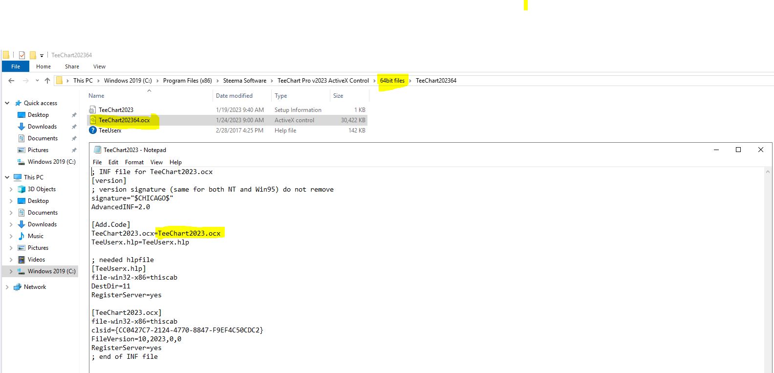

Hi Team,
We are facing issue with .cab file contents of latest release.Attached screenshot of contents and mappings.
TeeChart2023.inf contains an entry to TeeChart2023.ocx as mentioned below but there is no file with that name in the .cab file in the installed location(\Steema Software\TeeChart Pro v2023 ActiveX Control\64bit files\TeeChart202364)
TeeChart2023.ocx=TeeChart2023.ocx(After Extraction,We don't have TeeChart2023.ocx file inside the .cab file,this should be updated)
Please address above issue as we have dependency with the .cab files in 64bit version.
Thanks!
Srikanth Ananthoju

Hi Srikanth,
yes, you're correct.
I've been fixed this problem. Now, just looking at the other problem in order to reproduce it on 64bits and then we'll publish a new maintenance asap.

Thanks for looking in to it, will be awaiting for complete fix for both issues.
