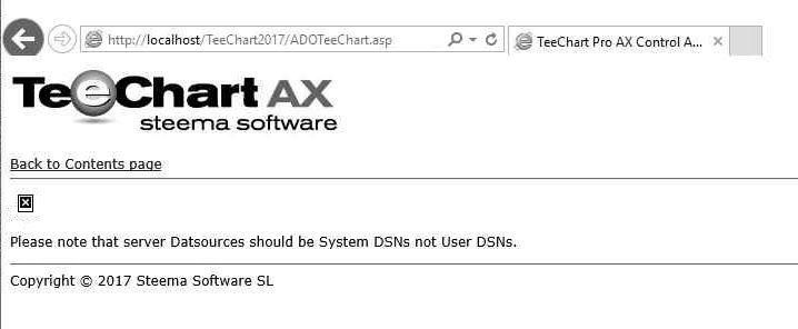

I installed TeeChart Prov2017 ActiveX Control on Microsoft Server 2016 OS with IIS. I selected "install internet Demo" and while the demo files were installed, no virtual directory was created. So I created it. When I run "ASP Server examples" from Start, and select "ADO Example", I get no image, just a black X. (See Capture1.jpg)

While that got rid of the MSINET.OCX not found error, the ASP examples are still not working. Perhaps I'm missing more than just MSINET.OCX? Can you tell me why the setup didn't create the virtual directory for me? Since your setup did not add the virtual website, I was forced to do this myself, are there maybe some settings I missed?
I'm starting to get confused, is this product supported on Microsoft Server 2016 Standard running IIS 10.0.14393? Specifically I need ASP support to show ADO based line charts. This is for a previous solution we provided using v5 and it worked perfectly.
