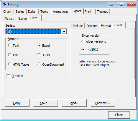

Finally, worth to mention here, with the coming TeeChart VCL v2017.20, and with the recently published TeeChart ActiveX v2017.0.0.0, the export to .xlsx is available through the editor:
