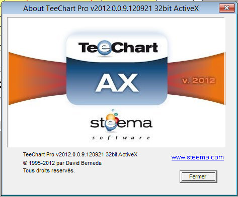

Re: asAxisBreaks --> Access violation
V2012.0.0.9 120921 and I use Windows 8
- TEECHARTBUILD.PNG (109.2 KiB) Viewed 25440 times
