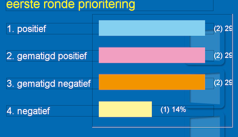

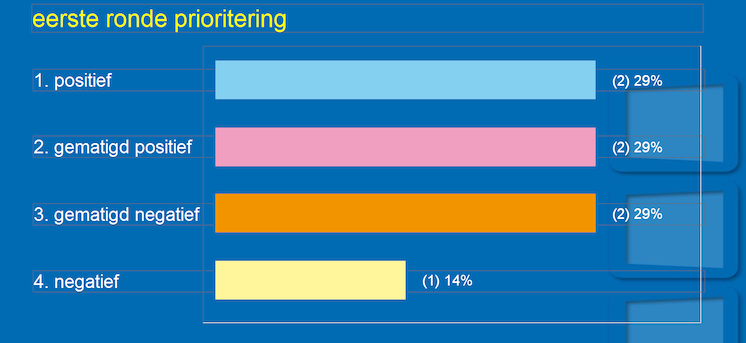

Depending on the resolution of the computer in use the horizontal bar chart can show the marks for the series values running off the edge of the chart.
This is how it shows how it looks on a high res display, which is fine

This image shows the same chart on a lower res screen, with exactly the same settings for fonts, panel margins, axis, etc.
Screen shot 2012-12-03 at 17.16.47.png (57.46 KiB) Viewed 8281 times
I've looked around but can't see how to interrogate the TeeChart object to find out if the text for the marks appear off the chart area.
So my question is how to do this? I know adjusting the right margin of the panel fixes the problem, however this fixes it only for certain screen resolution/chart width/font size combinations - of which there are many. This needs to be dynamic as the width of the chart, the font used for the marks and the text in the marks are all variable.
