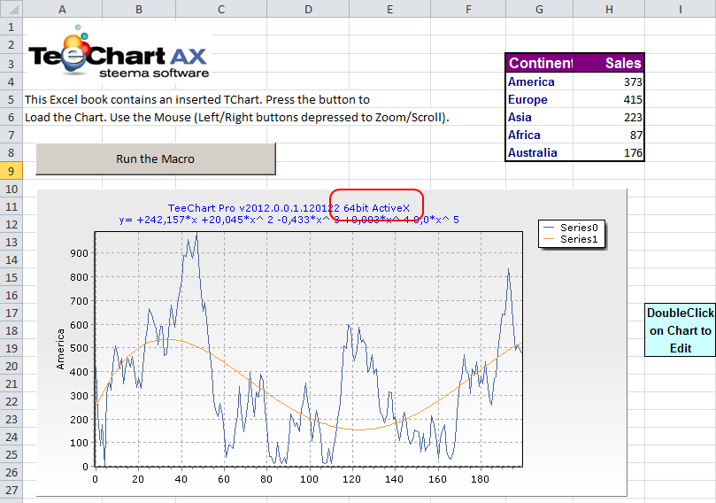

Post by Yeray » Fri May 25, 2012 10:41 am
Hi Jack,
It seems to work fine here in Win7 x64 + Office x64.
I've modified the VB code a little bit to both show the formula and the TeeChart version. Instead of:
TChart1.Header.Text.Text =  tmp
I use:
TChart1.Header.Text.Text = TChart1.Version
TChart1.Header.Text.Add tmp
And this is what I get:
Re: AnswerVector
Post by Yeray » Fri May 25, 2012 10:44 am
Hi Jack,
Note the first version including a 64bit ocx is the latest one: v2012.0.0.1. And the 64bit ocx is needed if you want to use TeeChart in an Office x64. So please, make sure you have the latest version installed and both 32 and 64 bit ocx are registered in the machine.
