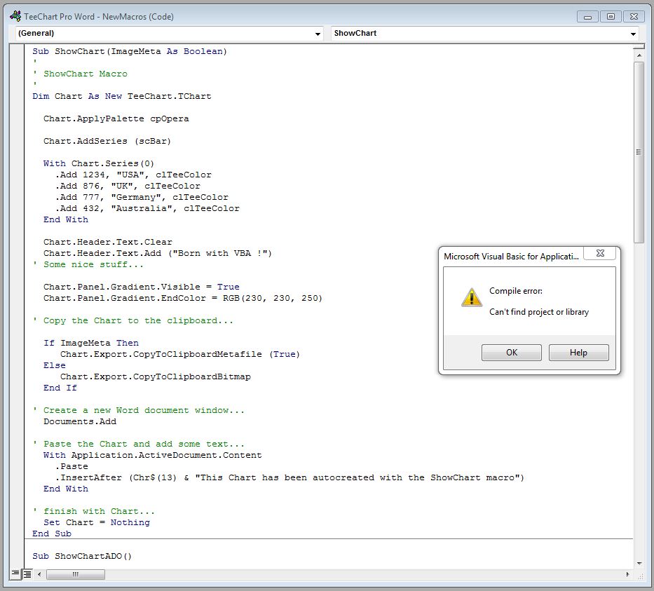

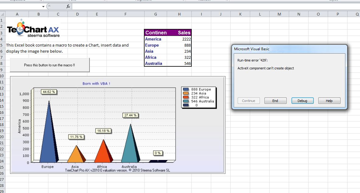

I just downloaded and installed the final AX 2012 version. After a quick check it turns out that I still have the same problem. My applications crash as soon as the Teechart component is initialized.
What is working are the demo's, so the installation should be OK.
What is not working are the Excel en Word examples. The produce simular errors (see pictures) as my applications.
Excel error
Excel error.JPG (118.51 KiB) Viewed 25657 times
Word error
Word error.JPG (113.9 KiB) Viewed 25657 times
Are there other things I can check? Like I said before, replacing the 2012 ocx by renaming the 2011 ocx solves the issue.
