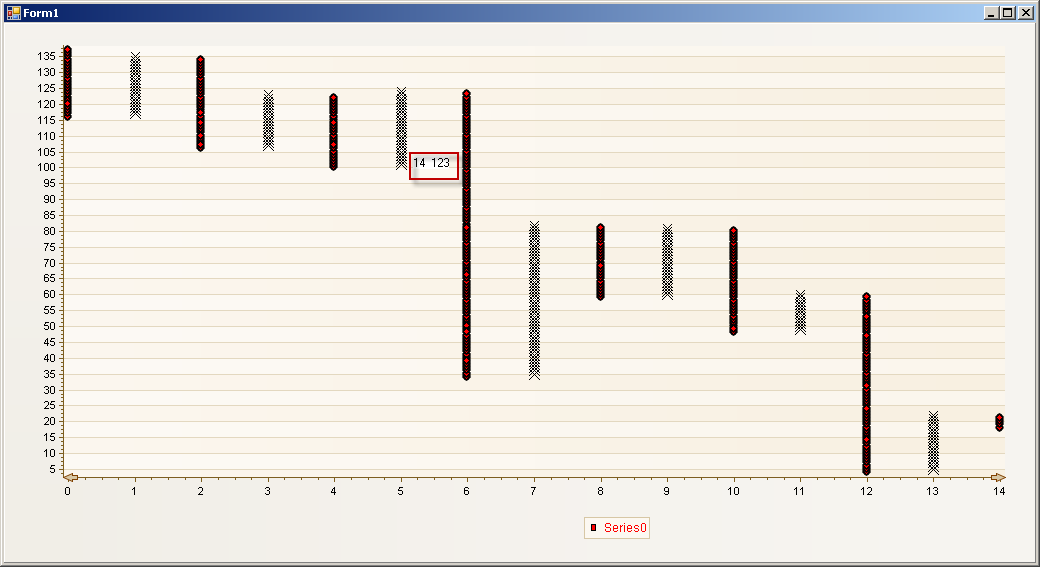

guilz2010
Posts: 63
Location: Paris, France
Re: P&F Chart- function Series.Clicked always returns -1
Post by guilz2010 » Tue Nov 22, 2011 10:48 am
Hi Yeray
Thanks for your reply
I actually implemented you Code in a VB.Net application:
Private Function ClickedPF(ByVal Chart As AxTeeChart.AxTChart, ByVal XPos As Integer, ByVal YPos As Integer, ByRef text As String) As Integer
        Dim tmpX, i, tmpCol, tmpColGroup As Integer
        Dim tmpDistance, tmpLow, tmpHigh, tmp As Double
        Dim tmpIsDown As Boolean
        Dim result As Integer = -1
        Try
            With AxTChart.Series(0).asPointFigure
                tmpDistance = .ReversalAmount * .BoxSize
                tmpLow = .LowValues.First
                tmpHigh = .HighValues.First
                tmpCol = 0
                tmpColGroup = 0
                tmpX = AxTChart.Series(0).CalcXPosValue(tmpCol)
                If calcRect(tmpX, tmpLow, tmpHigh).Contains(XPos, YPos) Then
                    text = CStr(.HighValues.Value(0))
                    Return 0
                End If
                tmpIsDown = True
                For i = 1 To .DateValues.Count - 1
                    If tmpIsDown Then
                        tmp = .LowValues.Value(i)
                        If tmp <= (tmpLow - .BoxSize) Then
                            If calcRect(tmpX, tmp, tmpLow - .BoxSize).Contains(XPos, YPos) Then
                                text = CStr(.LowValues.Value(i))
                                Return i
                            End If
                            tmpLow = tmp
                        Else
                            tmp = .HighValues.Value(i)
                            If tmp >= (tmpLow + tmpDistance) Then
                                tmpCol = tmpCol + 1
                                tmpHigh = tmp
                                If calcRect(tmpX, tmpLow + .BoxSize, tmpHigh).Contains(XPos, YPos) Then
                                    text = CStr(.HighValues.Value(i))
                                    Return i
                                End If
                                tmpIsDown = False
                                tmpColGroup = tmpColGroup + 1
                            End If
                        End If
                    Else
                        If tmp >= (tmpHigh + .BoxSize) Then
                            If calcRect(tmpX, tmpHigh + .BoxSize, tmp).Contains(XPos, YPos) Then
                                Return i
                            End If
                            tmpHigh = tmp
                        Else
                            If tmp <= (tmpHigh - tmpDistance) Then
                                tmpCol = tmpCol + 1
                                tmpLow = tmp
                                If calcRect(tmpX, tmpLow, tmpHigh - .BoxSize).Contains(XPos, YPos) Then
                                    Return i
                                End If
                                tmpIsDown = True
                            End If
                        End If
                    End If
                Next
            End With
            Return result
        Catch ex As Exception
        End Try
    End Function
    Private Function calcRect(ByVal tmpX As Integer, ByVal tmpLow As Double, ByVal tmpHigh As Double) As Rectangle
        Dim size As Size
        Dim location As Point
        With AxTChart
            location.X = tmpX - Cursor.Size.Width
            location.Y = .Series(0).CalcYPosValue(tmpHigh) - Cursor.Size.Height
            size.Height = .Series(0).CalcYPosValue(tmpLow) - .Series(0).CalcYPosValue(tmpHigh) + 2 * Cursor.Size.Width
            size.Width = 2 * Cursor.Size.Width
        End With
        Return New Rectangle(location, size)
    End Function
the clickedPF function is called when chart_dblclick event is raised:
Public Class Form1
    Public Sub New()
        ' This call is required by the Windows Form Designer.
        InitializeComponent()
        ' Add any initialization after the InitializeComponent() call.
        With AxTChart
            .AddSeries(TeeChart.ESeriesClass.scPointFigure)
            .Series(0).FillSampleValues()
        End With
Private Sub AxTChart_OnDblClick(ByVal sender As Object, ByVal e As System.EventArgs) Handles AxTChart.OnDblClick
        Dim text As String = ""
        Cursor = Cursors.WaitCursor
        Dim MousePosInchart As Point
        MousePosInchart = AxTChart.PointToClient(New Point(MousePosition.X, MousePosition.Y))
        Dim index As Integer = ClickedPF(AxTChart, MousePosInchart.X, MousePosInchart.Y, text)
        Cursor = Cursors.Arrow
        If index <> -1 Then
            AxTChart.Repaint()
            AxTChart.Canvas.BackColor = System.Drawing.ColorTranslator.ToOle(Color.White)
            AxTChart.Canvas.Brush.Style = TeeChart.EBrushStyle.bsSolid
            AxTChart.Canvas.Pen.Color = System.Drawing.ColorTranslator.ToOle(Color.Red)
            AxTChart.Canvas.Brush.Color = System.Drawing.ColorTranslator.ToOle(Color.White)
            AxTChart.Canvas.TextOut(MousePosInchart.X + 10, MousePosInchart.Y, CStr(AxTChart.Series(0).asPointFigure.DateValues.Value(index)) & "  " & text)
        Else
            AxTChart.Repaint()
        End If
End Class
but it still doesn't work fine: the displayed value is the same for the whole column, although different point where clicked
and sometimes i get a value displayed even when i click outside the serie
i attached a screenshot with an example of the result i get
do you have any suggestions?
thanks in advance
Point and figure sample

guilz2010 wrote:the displayed value is the same for the whole column, although different point where clicked
The Clicked function gives different indexes and thus the example shows different values in a same column for me with the Delphi example I posted.
I haven't seen what could be but I guess it has to be a difference that is affecting the behaviour.
guilz2010 wrote:and sometimes i get a value displayed even when i click outside the serie
I've seen in your calcRect function you use the Cursor.Size to calculate the rectangle width and height. I see in ActiveX you can't access to the asPointFigure.Pointer property (I'll add it to the wish list for future releases) but the values given by Cursor.Size may be wrong. I'd try using hardcoded values, for example 5 pixels width and height.
Just one tip: To test the rectangles calculated, you could draw them at the end of the Clicked function:
    Chart1.Canvas.Rectangle(Result);
And call the Clicked function at OnAfterDraw event to have a more stable draw:
  Clicked(PointFigure1,0,0); //just for the rectangles drawing, the X and Y are irrelevant
