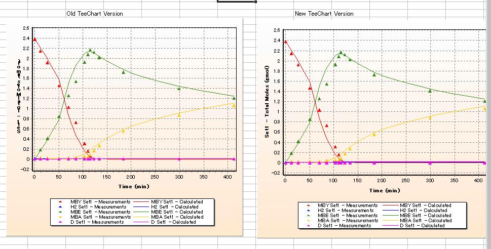

I have found another issue with the new release of the ActiveX control (v8.0.0.5 and v8.0.0.6).
When the chart is pasted into excel the text in the Y-Axis is displayed incorrectly (the attached screenshot shows the problem). This issue happens in Windows XP Japanese version. Also in v7.0.1.3 it worked correctly.
Is there a workaround to this problem?
Note: The labels in the screenshot ("New TeeChart Version" and "Old TeeChart Version") are wrong and must be swapped.

I'm not sure to understand the problem and see it in the pictures. I see the Y axis title rotated in the picture labeled as "Old TeeChart Version" and some characters overlapping the others. Is that what you would like to achieve with the "New Teechart version" and couldn't?

I made a mistake labeling the two graphs when I pasted them in Excel, the graph labeled as "Old TeeChart Version" was actually made with the most recent version of the TeeChart control (v8.0.0.6). And the graph labeled as "New TeeChart Version" was made with the TeeChart v7.0.1.3.
Basically the graph at the left (v8.0.0.6) is not working correctly and the graph at the right (v7.0.1.3) is working ok.
What I need is to work as it was working in v7.0.1.3. Also remember that this issue doesn't happen in all Windows versions, so far we have found the issue in the japanese version.

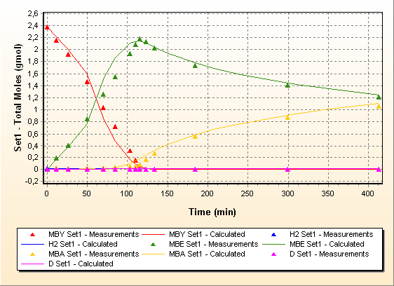

Running your exe here with the latest TeeChart AX eval registered, here it is the picture given by the "Copy to Clipboard" button:
The only thing I haven't followed from the steps described for you is the Excell 2000 part. I've pasted the clipboard into an Excell 2003 and into windows Paint, both with a correct result.
It's strange. You have International Support enabled in your machines, I assume.
