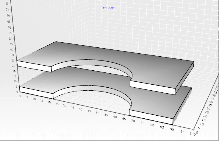

Hi!
I want to draw 3D objetcts like the picture number one. It has to have opaque flat walls and sections of the upper wall of every wall has to be cylindrical.
Till now, I managed to do several first downs but I'm still in my forties. I need to draw cylindrical surface opaque sections. My achievements are shown in picture number two.
Is there way to draw a cylindrical opaque section surface with axis parallel to the depth axis?
any hint ?
Thanks ...

Re: Is it posible to draw opaque cylinder surfaces in tchart.ocx
Post by Yeray » Mon May 24, 2021 10:59 am
I've been playing with your project from here and found the functions we provide don't allow to draw some polygons so I've added this to the public tracker (#2427).

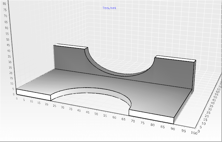

Post by Yeray » Thu Jun 03, 2021 5:43 pm
With Polygon3D (#2427) function you'll be able to get this:
Note that's still not a real arc. So it's done by drawing polygons side by side.

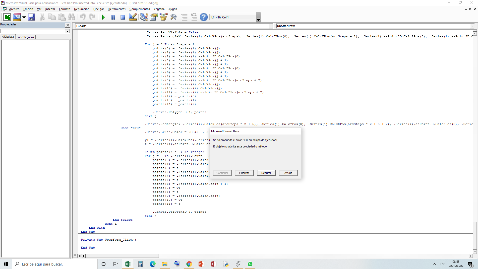

QuijoteMx
Posts: 13
Joined: Wed Mar 24, 2021 12:00 am
Location: Mexico
Post by QuijoteMx » Thu Jun 03, 2021 11:04 pm
Thanks for your response Yeray!
Both post are related. I'm just seen that there is a response in this thread: Is it posible to draw opaque cylinder surfaces in tchart.ocx.
The second post is about 3D flat polygons not parallel to cartesian planes.
For parallel 3D planes to cartesian, I'm using after_draw method of the tChart and the canvas methods of the series:
PolygonWithZ, RectangleWithZ, Plane3D and RectangleY, but what about tilted planes?
The cylindrical surface I'm trying to draw has its axis parallel to Depth axis (z coordinate). The code you attach produces cylindrical surfaces with axis colineal to left axis (y coordinates). I hope it can be modified to make it colinear to depth axis.
I hope you can give me a hint about how to draw 3D flat polygons not parallel to cartesian planes
Thanks ...
Post by Yeray » Tue Jun 08, 2021 10:45 am
It takes a bit of time to play with trigonometry, but this is what I understand you are trying to achieve:

    Dim y, z As Integer
    If notFinished Then
       Exit Sub
    End If
    ystart = 250: ydelta1 = 0: ydelta2 = 0
    With TChart1
            .Canvas.Pen.Visible = False
            For i = 0 To TChart1.SeriesCount - 1
                  Select Case planeType(i)
                  Case "XY"
                                .Canvas.Brush.Color = RGB(225, 225, 225)
                                .Canvas.RectangleWithZ .Series(i).CalcXPos(0), .Series(i).CalcYPos(1), .Series(i).CalcXPos(2), .Series(i).CalcYPos(3), .Series(i).asPoint3D.CalcZPos(0)
                  Case "YZ"
                                .Canvas.Brush.Color = RGB(127, 127, 127)
                                .Canvas.Plane3D .Series(i).CalcXPos(0), .Series(i).CalcYPos(0), .Series(i).CalcXPos(2), .Series(i).CalcYPos(2), .Series(i).asPoint3D.CalcZPos(0), .Series(i).asPoint3D.CalcZPos(2)
                  Case "XZ"
                                .Canvas.Brush.Color = RGB(200, 200, 200)
                                .Canvas.RectangleY .Series(i).CalcXPos(0), .Series(i).CalcYPos(0), .Series(i).CalcXPos(2), .Series(i).asPoint3D.CalcZPos(0), .Series(i).asPoint3D.CalcZPos(3)
                  Case "XYZ"
                                ReDim points(15) As Integer
                                .Canvas.RectangleWithZ .Series(i).CalcXPos(arcSteps), .Series(i).CalcYPos(0), .Series(i).CalcXPos(arcSteps + 2), .Series(i).CalcYPos(arcSteps + 2), .Series(i).asPoint3D.CalcZPos(0)
                                For j = 0 To arcSteps - 1
                                    points(0) = .Series(i).CalcXPos(j)
                                    points(1) = .Series(i).CalcYPos(0)
                                    points(2) = .Series(i).asPoint3D.CalcZPos(j)
                                    points(3) = .Series(i).CalcXPos(j + 1)
                                    points(4) = .Series(i).CalcYPos(0)
                                    points(5) = .Series(i).asPoint3D.CalcZPos(j + 1)
                                    points(6) = .Series(i).CalcXPos(j + 1)
                                    points(7) = .Series(i).CalcYPos(arcSteps + 2)
                                    points(8) = .Series(i).asPoint3D.CalcZPos(j + 1)
                                    points(9) = .Series(i).CalcXPos(j)
                                    points(10) = .Series(i).CalcYPos(arcSteps + 2)
                                    points(11) = .Series(i).asPoint3D.CalcZPos(j)
                                    points(12) = points(0)
                                    points(13) = points(1)
                                    points(14) = points(2)
                                    .Canvas.Polygon3D 4, points
                                Next j
                                .Canvas.RectangleWithZ .Series(i).CalcXPos(arcSteps * 2 + 5), .Series(i).CalcYPos(0), .Series(i).CalcXPos(arcSteps * 2 + 5 + 2), .Series(i).CalcYPos(arcSteps + 2), .Series(i).asPoint3D.CalcZPos(0)
                    Case "XZH"
                                y = .Series(i).CalcYPos(0)
                                z1 = .Series(i).asPoint3D.CalcZPos(.Series(i).Count - 2)
                                ReDim points(4 * 3) As Integer
                                For j = 0 To .Series(i).Count - 2
                                    points(1) = y
                                    points(4) = y
                                    points(7) = y
                                    points(8) = z1
                                    points(10) = y
                                    points(11) = z1
                                Next j
                    Case "XZY"
                                .Canvas.RectangleY .Series(i).CalcXPos(arcSteps), .Series(i).CalcYPos(0), .Series(i).CalcXPos(arcSteps + 2), .Series(i).asPoint3D.CalcZPos(0), .Series(i).asPoint3D.CalcZPos(arcSteps + 2)
                                    points(1) = .Series(i).CalcYPos(j)
                                    points(2) = .Series(i).asPoint3D.CalcZPos(0)
                                    points(4) = .Series(i).CalcYPos(j + 1)
                                    points(5) = .Series(i).asPoint3D.CalcZPos(0)
                                    points(7) = .Series(i).CalcYPos(j + 1)
                                    points(8) = .Series(i).asPoint3D.CalcZPos(arcSteps + 2)
                                    points(10) = .Series(i).CalcYPos(j)
                                    points(11) = .Series(i).asPoint3D.CalcZPos(arcSteps + 2)
                                Next j
                                .Canvas.RectangleY .Series(i).CalcXPos(arcSteps * 2 + 5), .Series(i).CalcYPos(0), .Series(i).CalcXPos(arcSteps * 2 + 5 + 2), .Series(i).asPoint3D.CalcZPos(0), .Series(i).asPoint3D.CalcZPos(arcSteps + 2)
                    Case "XYH"
                                y1 = .Series(i).CalcYPos(.Series(i).Count - 2)
                                z = .Series(i).asPoint3D.CalcZPos(0)
                                    points(2) = z
                                    points(5) = z
                                    points(7) = y1
                                    points(8) = z
                                    points(10) = y1
                                    points(11) = z
                                Next j
                End Select
            Next i
    End With

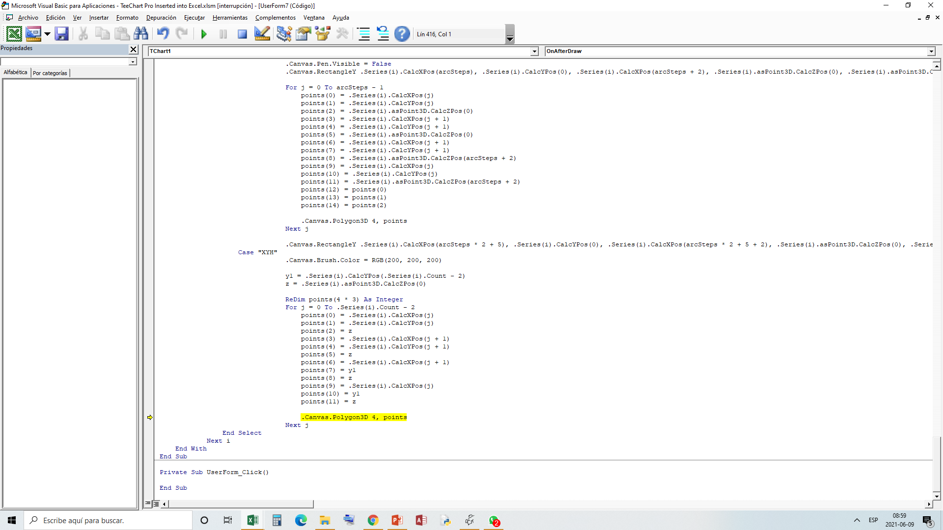

Post by QuijoteMx » Wed Jun 09, 2021 2:03 pm
Looks great Yeray!
But there is something wrong with my teeChart software installation.
I copied the code you provided but I got an error.
For some reason, the Canvas.Polygon3D method it's not recognized in my Excel-VBA instalation.
I'm attaching two screen shots of the code and the error.
What's wrong with my TeeChart Software...?
Error 1.png (209.8 KiB) Viewed 140233 times
Error 2.png (198.28 KiB) Viewed 140233 times

Post by Yeray » Wed Jun 09, 2021 6:21 pm
I'm sorry for the confusion. There's no TeeChart ActiveX version with Polygon3D function published yet.
When I said this:
I meant I was testing that function with a test version.
I will send you this test version so you can give it a try.
