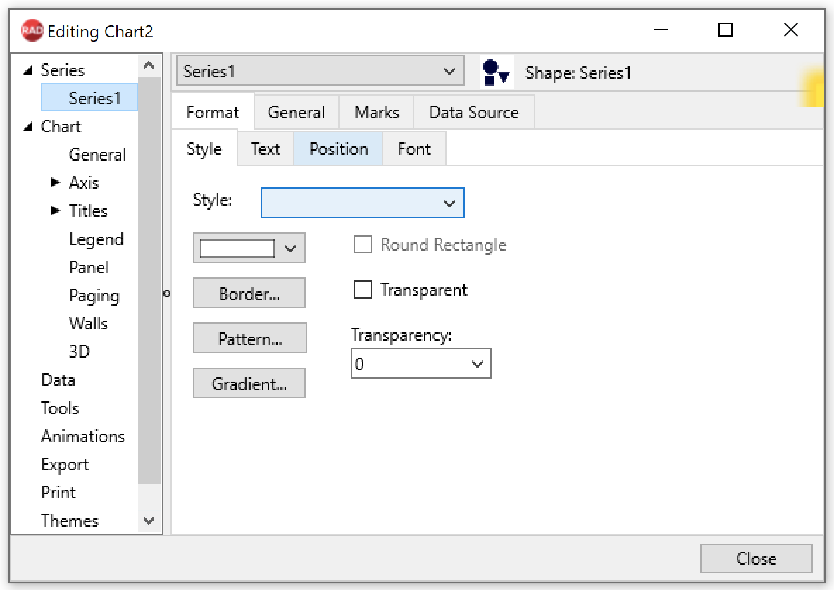

When adding a Shape Series, you cannot select a Style, or Text alignment, or the units.
In the FMXTee.Editor.Series.Shape the Combo boxes are empty, and the RadioGroup things were not ported to FMX.
At least the new FMX - TRadiogroup was not filled with items using the Add function.
Screenshot 2021-11-16 at 17.52.41.png (64.64 KiB) Viewed 20740 times

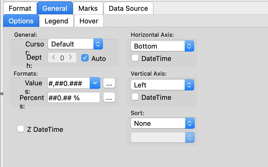

In OSX some of the labels are broken, wrapped, or cut off because of formatting in the individual FMXTee.Editor.xyz files
Example:
Screenshot 2021-11-16 at 18.09.14.png (272.31 KiB) Viewed 20740 times
This issue spreads over a few different Editor tabs.
I've seen that so I've added to the public tracker at #2486. And I've corrected it.
I've added it to the public tracker at #2487.
