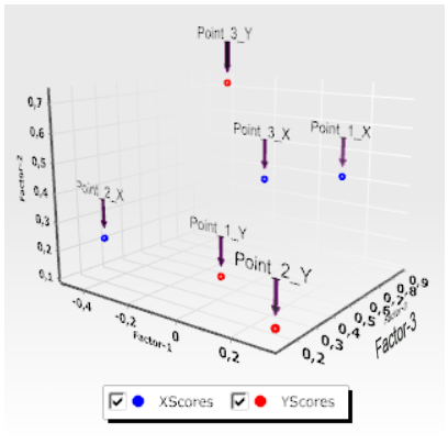

the change in TGLCanvas.RotateLabel3D indeed fixes the position of the axis label but still, the orientation is obviously wrong:
Wrong orientation of depth axis label
Can you please fix that too?
The label should like all others run along the axis.
Thanks and best regards,
Thomas

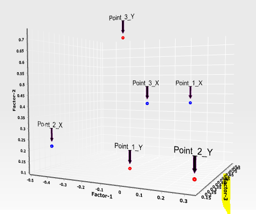

Post by axrDegen » Fri Dec 13, 2019 10:53 am
No, that doesn't help, the Title still shows a wrong alignment:
wrong alignment
The Title should run parallel to the axis, like the Titles of all other axes,
this title rotates perpendicular to the axis around the axis.
Thomas

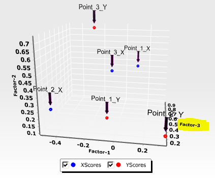

Post by axrDegen » Mon Dec 16, 2019 10:08 am
Hello Yeray,
that is indeed bad, I had expected it to look something like that:
best regards,
Thomas
Posts: 9562
Re: Some long standing bugs
Post by Yeray » Tue Dec 17, 2019 11:08 am
That could be achieved incrementing the font size. However, the axis title would be in a plane perpendicular to the labels for the same axis. So, if you rotate the chart to see the title from the front, you won't be able to read the labels.
