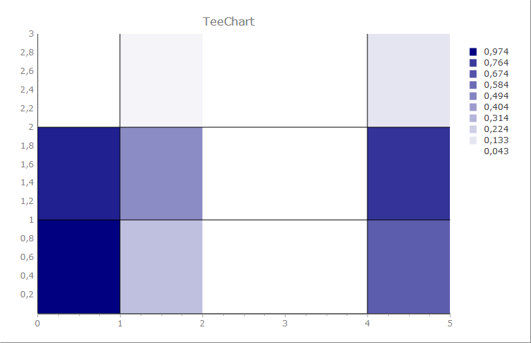

Revisiting this post of mine, I believe things have changed slightly. Using this code in TeeChart.NET gives us the corresponding image:
    private Steema.TeeChart.Styles.ColorGrid colorGrid;
      double x, y, z;
      Random rnd = new Random();
      int length = 2;
      tChart1.Series.Add(colorGrid = new Steema.TeeChart.Styles.ColorGrid());
      colorGrid.IrregularGrid = false;
      for (int i = 0; i <= length; i++)
        x = i * i;
        for (int j = 0; j <= length; j++)
          z = j;
          y = rnd.NextDouble();
          colorGrid.Add(x, y, z);

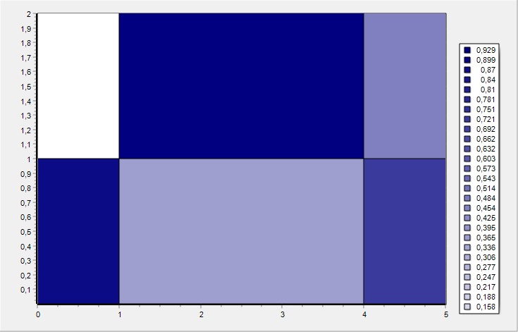

whereas in ActiveX/Delphi we have:
procedure TForm1.InitializeChart;
var
  colorGrid : TColorGridSeries;
  x, y, z : Double;
  length, i, j : Integer;
     colorGrid := TColorGridSeries.Create(Self);
     colorGrid.ParentChart := Chart1;
         length := 2;
         Chart1.View3D := false;
         colorGrid.IrregularGrid := true;
         for i := 0 to length do
            x := i * i;
            for j := 0 to length - 1 do
               z := j;
               y := Random;
               colorGrid.AddXYZ(x, y, z);
I think TeeChart.NET has been improved in this area. With respect to plotting so many points, can you please repost the example project so I can look at it again? The passage of time has left me without access to your original one, I'm afraid.
