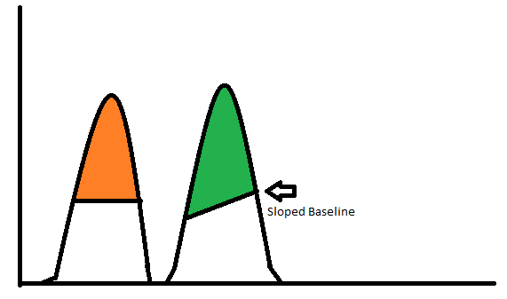

I am trying to implement shading under a curve. I have successfully used the information/examples from this post: https://www.steema.com/support/viewtopic.php?t=10307
That post explains how to use the SeriesRegionTool to color an area under a curve starting at one X value (X1), ending at a second X value (X2) with an origin value (Y) that defines the baseline of the shaded area by the points (X1, Y) and (X2, Y). The SeriesRegionTool works great for this!
I will now need to extend this solution to handle shading when the baseline points do not share the same Y value (i.e. the baseline is sloped). Here's an example image where the left curve is the straight baseline I currently have working with the SeriesRegionTool and the right curve shows the sloped baseline that I need help implementing:
I'd like to continue using the SeriesRegionTool for this - but it doesn't seem to be able to handle multiple origin points. Can you please help me understand the best way to shade the area under the curve with a sloped baseline?
Thanks!!

pmartin wrote:
Thu Aug 08, 2019 2:56 pm
I think the only way you're going to be able to do this is to derive a new Tool from our SeriesRegionTool and then adapt it to your needs. Unfortunately some of the key methods of the SeriesRegionTool are private rather than protected virtual, but in order to help you we can share some of our source code with you:

Please be aware that deriving TeeChart classes is perfectly valid under our license, although we do count it as 'source-code modification' and as such give no support to such classes. It is worth mentioning that there are a couple of options if you are not able to make the changes yourself to your satisfaction:
1) request a new feature request on http://bugs.teechart.net/
2) ask sales@steema.com for a quote from us for the work
