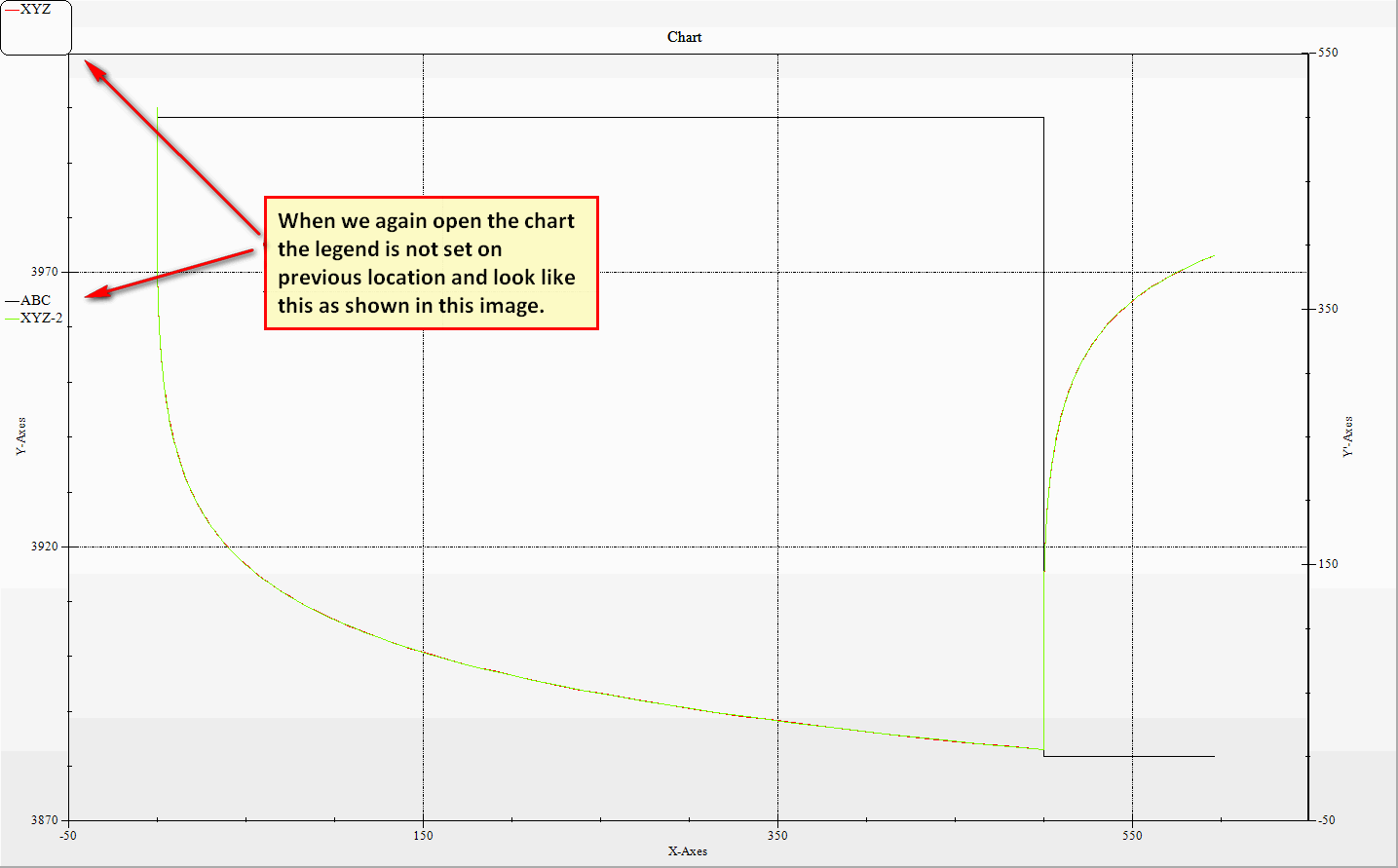

The problem is that we set the legend position on the chart and then close the chart again we open same chart the legend doesn't show at previous position.
We set the legend position on Resize and GetLegendPos events. In these events we write the below code is as follows:-

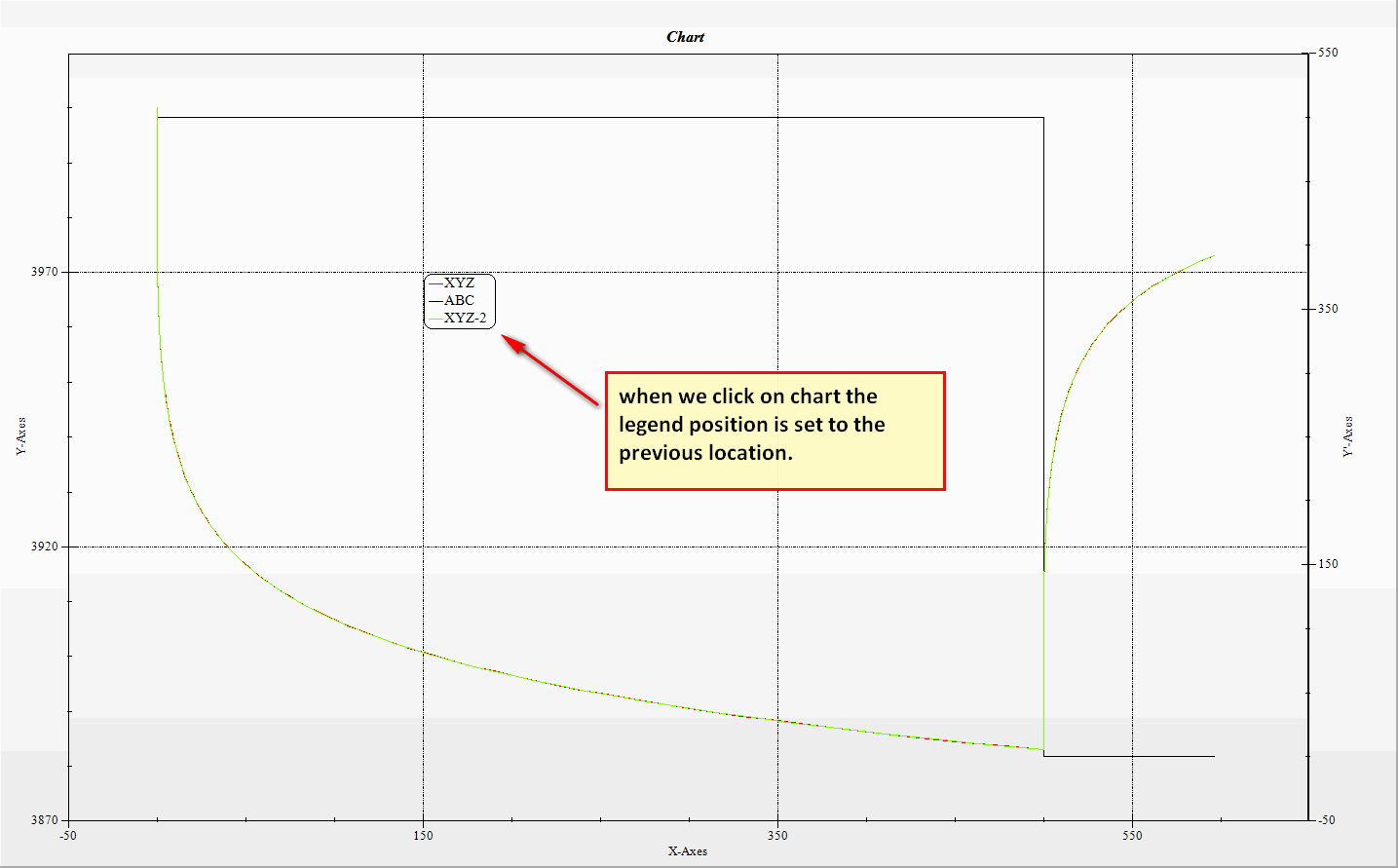

But when we click on chart the legend position is set to the previous location.
We don't know whether it is a refreshing issue or some other problem. Kindly guide us.

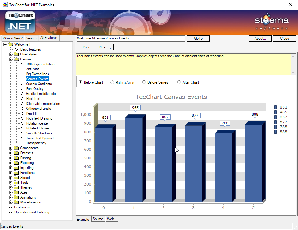

amol wrote: We don't know whether it is a refreshing issue or some other problem. Kindly guide us.
Yes, I think that the legend needs to repositioned at every chart repaint and not just when the chart is resized. You can use one of the repaint events shown in this example:
