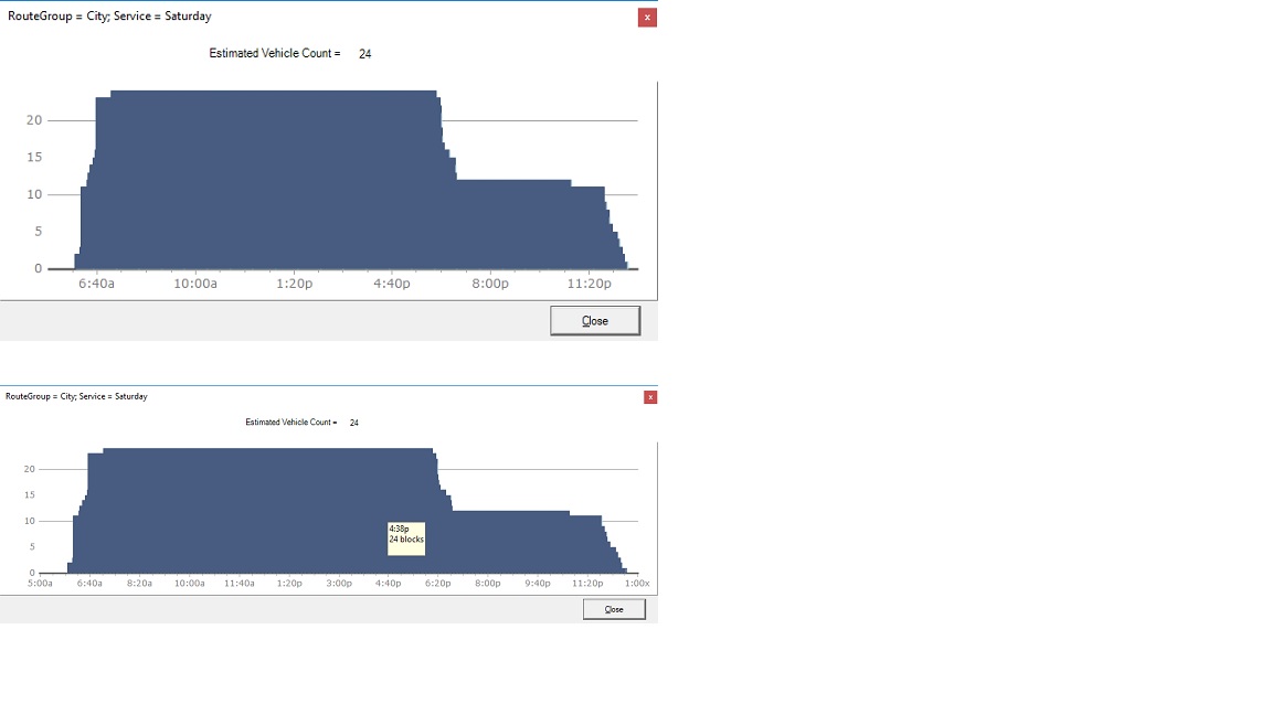

Re: Clicked method of Series always returns -1
The following code seems to work okay in that version here:
I made a gif showing it working on my machine [link here]:
Bar series;
series = new Bar(tChart1.Chart);
series.FillSampleValues();
tChart1.MouseMove += TChart1_MouseMove;
private void TChart1_MouseMove(object sender, MouseEventArgs e)
int index = series.Clicked(e.X, e.Y);
tChart1.Header.Text = index > -1 ? "Bar CLICKED index: " + index : "Bar NOT clicked";
tChart1.ShowEditor();

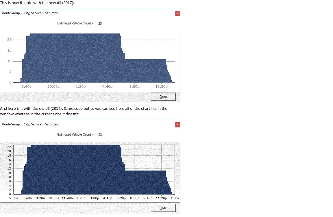

Hi Christopher,
I investigated more and I think the reason I have to widen the form in order to make it work is because with the new dll it doesn't put the whole chart in the window whereas with the old one it does (the code doing this is the same). Is there a property or something else that has changed and I need to set in order to have it behave like before and have it work without needing to widen the form window?
Thank you,
Michael
P.S. Attached is an image with the 2 charts using the 2 versions of the dll.
Thank you,
Michael

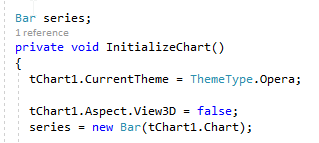

you can change the default theme back to the one that was default in the earlier version with code such as the following:

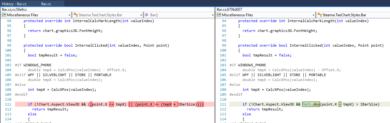

- Guru
- Posts: 1603
Hello Michael,
The fix is in the InternalClicked() method of the Bar class in Bar.cs:
if you use the HorizBar series a similar fix can be made there too.

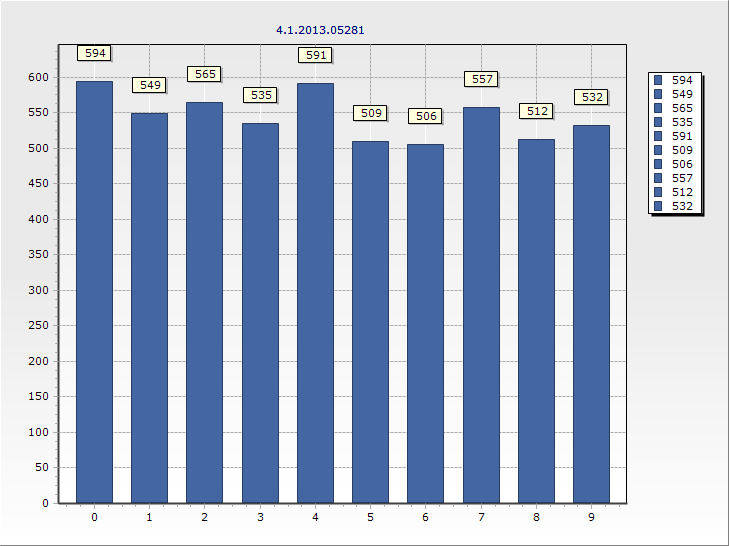

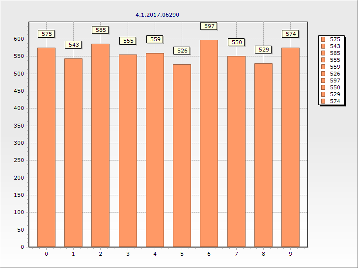

Hello Michael,
Try this code with your two dlls:
Here, with the latest dll and with one from 2013, I obtain the following:
in this scenario I cannot detect any difference in the increment between the labels on the left axis.
TChart tChart1;
Bar series;
private void CreateChart(bool usetheme = true)
tChart1 = new TChart(usetheme);
splitContainer1.Panel2.Controls.Add(tChart1);
Func<string> Version = () =>
string version = typeof(Chart).Assembly.GetName().Version.ToString();
if (version.Length == 13)
version = version.Insert(9, "0");
return version;
CreateChart(false);
Random rnd = new Random();
for (int i = 0; i < 10; i++)
series.Add(rnd.Next(500, 600));
tChart1.Header.Text = Version();
