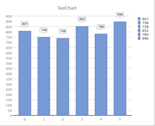

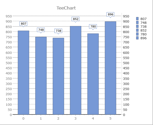

Using the following code:
      Bar series = new Bar(tChart1.Chart);
      series.FillSampleValues();
    private void Button_Click_1(object sender, RoutedEventArgs e)
      switch (tChart1[0].VertAxis)
        case VerticalAxis.Left:
          tChart1[0].VertAxis = VerticalAxis.Right;
          break;
        case VerticalAxis.Right:
          tChart1[0].VertAxis = VerticalAxis.Both;
          break;
        case VerticalAxis.Both:
          tChart1[0].VertAxis = VerticalAxis.Left;
          break;
        default:
          break;
    private void Button_Click(object sender, RoutedEventArgs e)
      tChart1.Export.Image.PNG.Save(@"D:\FTP\TeeChart_" + DateTime.Now.Ticks.ToString() +".png");
I obtained the following three images:
Is the use of the Series' VertAxis property not sufficient for your needs?

Post by Jens Ramlow » Fri Oct 13, 2017 6:19 pm
Thank you, Christopher,
I didn't know about assigning VerticalAxis.Both to a data serie.
Perfect solution. :)
