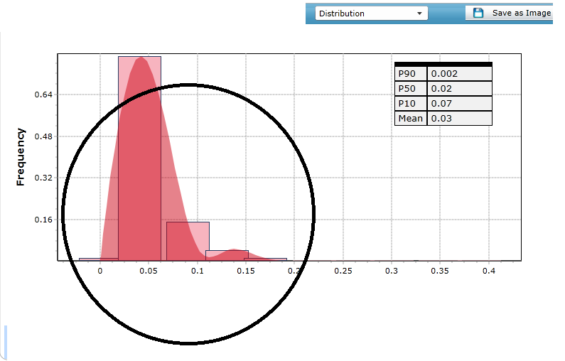

I have a bar chart based on data
x axis- 0.0 , 0.4 , 0.9, 0.13 ,0.17 ,0.22, 0.26, 0.30, 0.35, 0.39
Y-Axis- 0.01, 0.78, 0.15, 0.04, 0.01, 0,0,0,0,0
In this i have facing overlap and gap issue. Please look this.

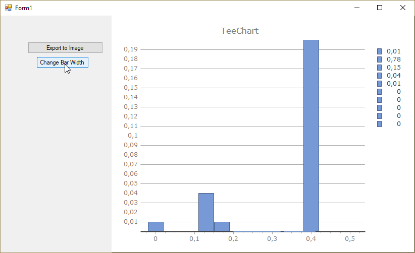

Using the latest version of TeeChart.dll and the following code:
    Bar series;
      double[] xvalues = new double[] { 0.0, 0.4, 0.9, 0.13, 0.17, 0.22, 0.26, 0.30, 0.35, 0.39 };
      double[] yvalues = new double[] { 0.01, 0.78, 0.15, 0.04, 0.01, 0, 0, 0, 0, 0 };
      series = new Bar(tChart1.Chart);
      series.Add(xvalues, yvalues);
      series.Marks.Visible = false;
      tChart1.Axes.Bottom.SetMinMax(0, 0.5);
      tChart1.Axes.Left.SetMinMax(0, 0.2);
      series.CustomBarWidth = 30;
      //series.BarWidthPercent = 20;

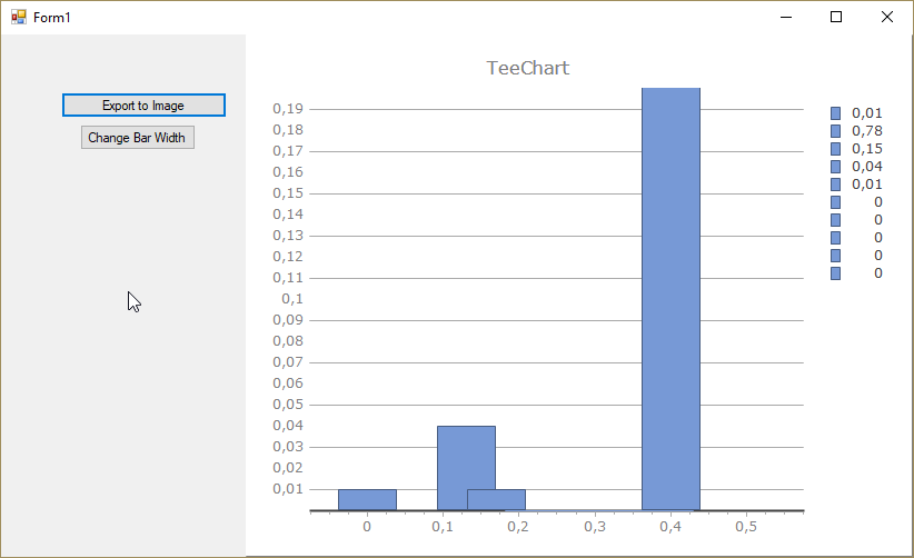

I obtain the following before the button click:
and after the click I obtain:
in this test both CustomBarWidth and BarWidthPercent work as expected. Which version of TeeChart.dll are you using?

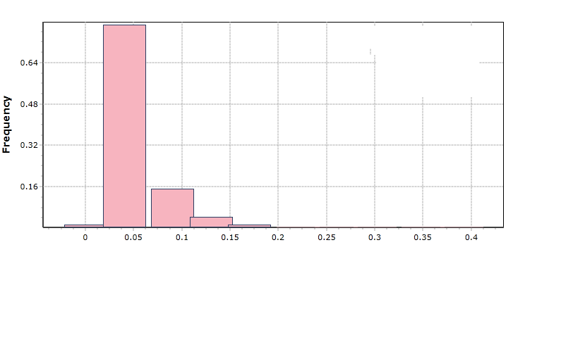

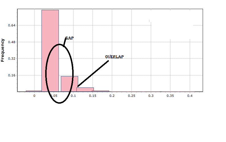

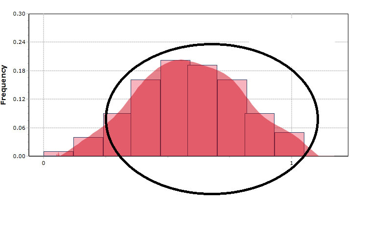

I would like to share that we can not fix the width of bars and my expectation is to combine the bars without gap and without overlap.
I am giving 2 more dataset.
Ist Dataset
X- 0.06,0.18,0.13,0.41,0.53,0.64,0.76,0.87,0.9,1.11
Y- 0.01,0.04,0.09,0.16,0.20,0.19,0.16,0.09,.0.05,.0.0
And the chart image is as below, in this case overlapping is coming. I am using silverlight.
IINd Dataset-
X- 0.0, 0.04 ,0.09 ,0.13 ,0.17 ,0.22 ,0.26 ,0.30 ,0.35 ,0.39
Y- 0.01, 0.78, 0.15 , 0.04, 0.01, 0, 0, 0, 0, 0
In This gap is coming-
Please provide dome fruitful solution. In Excel we are able to plot expected. And i am using percentage 100%.

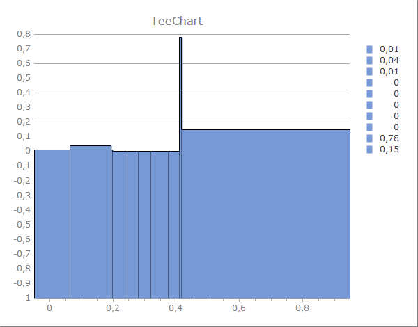

TeeChart has no facility for allowing the Bar series to draw bars of different widths. If you want bars of different widths you can use the Histogram series, e.g.
    Histogram series;
      series = new Histogram(tChart1.Chart);
      series.XValues.Order = ValueListOrder.Ascending;
      series.XValues.Sort();
      tChart1.Axes.Bottom.SetMinMax(0, 0.9);
      tChart1.Axes.Left.SetMinMax(-1, 0.8);
which gives me:
