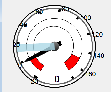

OK... So... We use dial gauges all over the place and I'm finally ready to make them look better!
This is what they look like now:
Not great, right?

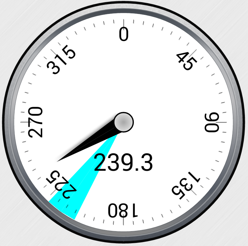

This one sure looks a lot nicer, doesn't it?
I'm fine with how the red bands come out but I would like things to look a little more finished and I like having that blue band (just a visual cue of kind of how things should be) _behind_ the needle (well, and triangular).

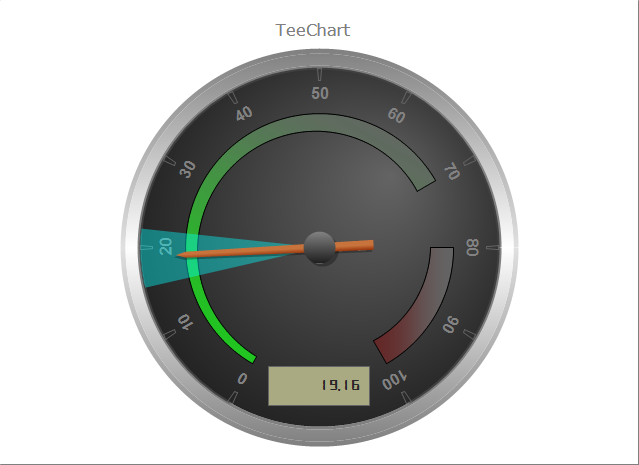

I obtain this:

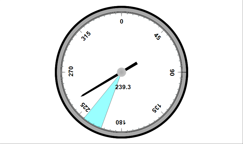

gives me the following:
is this near what you're looking for?

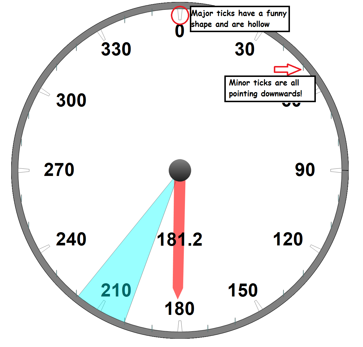

Well, we're closer.
I guess I'd like the ticks to resize, too, frankly. And to be different, of course. "Of course" because the customer always wants more, right? Anyway, in the visual editor the ticks seem to always end up as binaries in resources. The ones I have right now are hollow circles and hollow rectangles. Not exactly what I'm looking for!
We did this one in another lifetime... But we manually drew all of those ticks. I guess... It doesn't really feel like I should be drawing those manually.
Anyway, that looked like this.
Anyway, if I just resize the ticks (see code) then weird things happen...
This image is large because you can't see the weirdness when it's small...

Re: How can I add lines on gauge (and make them look better)?
Post by Christopher » Thu May 18, 2017 4:33 pm
dx0ddyu wrote: I guess I'd like the ticks to resize, too, frankly. And to be different, of course. "Of course" because the customer always wants more, right? Anyway, in the visual editor the ticks seem to always end up as binaries in resources. The ones I have right now are hollow circles and hollow rectangles. Not exactly what I'm looking for!
Okay. The current CircularGauge Ticks and MinorTicks are of the type GaugeSeriesPointer, which is derived from SeriesPointer and are basically a range of 2D shapes based on rectangles and ellipses. This was a design decision made when this series was written, and was a style more fashionable then than it seems to be now. I have added your request for an enhancement to this area to our issue-tracking software with id=1866 - in the meantime, to obtain Ticks and MinorTicks which are not based on SeriesPointer then they will have to be drawn manually.
