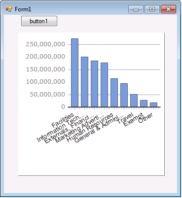

Here is separation of 0:
(problem #1 with descenders and ascenders overlapping)

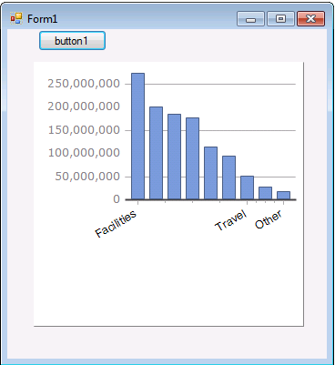

Here is separation of 1:
(problem #2 labels all but disappear when they could have been drawn every other one.)
Take a form and place a TChart and a button on the form. The code will take care of arranging things and the size of things.
Using the code below run the application to see overlaps in descenders and ascenders.
Also, push the button to see the problem between separation of 0 and 1. The labels all but disappear but could have been drawn every other label and had a separation of one percent.
So there are two problems:
  • Ascenders and descenders overlap when allowing the user to resize the chart with separation of 0.
  • Separation of 1 percent is not one percent but huge with even a one degree of angled text.

Good Morning,
I watched the video and in it I see you are running the code without the placement of components size / location given in the example code in the constructor to show to you the issue. Unfortunately, the customer does not continually resize the chart. They stop at locations where they would like to display the data. In some of those locations the users are seeing the issue. I explicitly gave code at one of those stop points. This issue gets worse when there are international characters that use more ascender/descender mix of characters. (I would have given an example of that but I was not sure that the international characters would get through the forum code post appropriately)
            this.Size = new Size(670, 509);
            this.button1.Location = new Point(34, 1);
If you had left that code which was contained in the constructor you would have gotten the exact same screen uploaded as a picture displayed in issue #1.
Yes, under a continuous resize it is hard to see the overlapping. That is why I gave you oneof the stop points where it was easy to see the problem.
Even during your video you display the issue. Here is a stopping point where there is an issue at 0:15 and 0:23 of the video. I see several other places during the video which also have the same problem.
You did not address the second issue with a separation of "1" giving such a large label separation. Should I open another forum thread for that issue and not place two problems in the same thread?

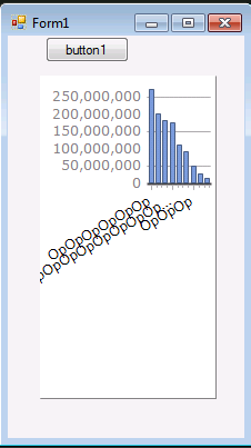

Here is another way to show the problem. Replace the code:
            TheSeries.Add(0, 273423155, "Facilities");
            TheSeries.Add(1, 201478304, "Information Tech...");
            TheSeries.Add(2, 184443667, "Externals, Financi...");
            TheSeries.Add(3, 177618980, "Marketing Adverti...");
            TheSeries.Add(4, 113353935, "Human Resources");
            TheSeries.Add(5, 93689069, "General & Admini...");
            TheSeries.Add(6, 51526793, "Travel");
            TheSeries.Add(7, 28238498, "Exempt");
            TheSeries.Add(8, 16809770, "Other");
With:
            TheSeries.Add(0, 273423155, "OpOpOpOpOpOp");
            TheSeries.Add(1, 201478304, "OpOpOpOpOpOpOpOp...");
            TheSeries.Add(2, 184443667, "OpOpOpOpOpOpOpOp...");
            TheSeries.Add(3, 177618980, "OpOpOpOpOpOpOpOpOp...");
            TheSeries.Add(4, 113353935, "OpOpOpOpOpOpOp");
            TheSeries.Add(5, 93689069, "OpOpOpOpOpOpOpOp...");
            TheSeries.Add(6, 51526793, "OpOpOp");
            TheSeries.Add(7, 28238498, "OpOpOp");
            TheSeries.Add(8, 16809770, "OpOpO");
You should see plenty of overlap. Here is another screen shot using the "Op" code change above:

biqpaulson wrote: You should see plenty of overlap. Here is another screen shot using the "Op" code change above:
Ah yes, here the overlap is clear, thank you.

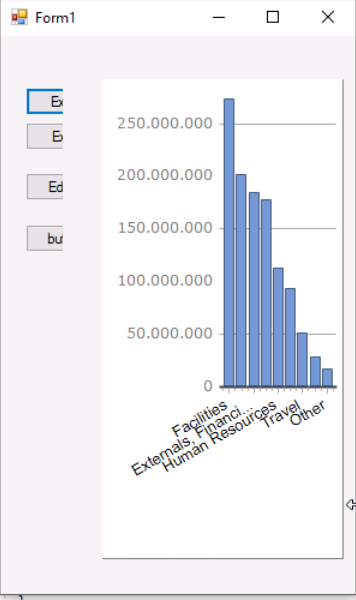

Post by biqpaulson » Mon Apr 10, 2017 8:48 pm
This helps a little but still get cruched together.
Is there a way to know how many pixels there are between grid lines (or between label ticks or even the labels themselves)?
biqpaulson
Posts: 93

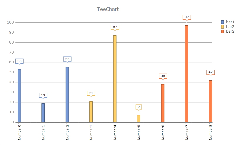

The following code:
      Random rnd = new Random();
      int count = 0;
      for (int i = 1; i < 4; i++)
        Bar bar = new Bar(tChart1.Chart);
        bar.MultiBar = MultiBars.SideAll;
        for (int j = 0; j < 3; j++)
          bar.Add(rnd.Next(100));
          tChart1.Axes.Bottom.Labels.Items.Add(count, "Number" + count.ToString());
          count++;
gives me this:
Is this more along the lines of what you would expect?
biqpaulson
Posts: 93
Re: Label Separation still a problem
Post by biqpaulson » Mon Apr 17, 2017 3:20 pm
Works great!
I did not know you could just use an increment for each label.
