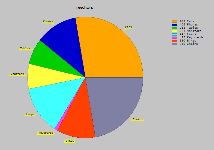

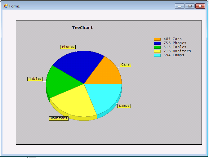

I would like to get normal callouts with the web theme.
In the following pictures please ignore the colors which in web theme are horrendous. Please concentrate on just the Marks.
I would like the Marks callout style which is in this chart:
But if I apply the Web theme I get this:

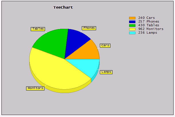

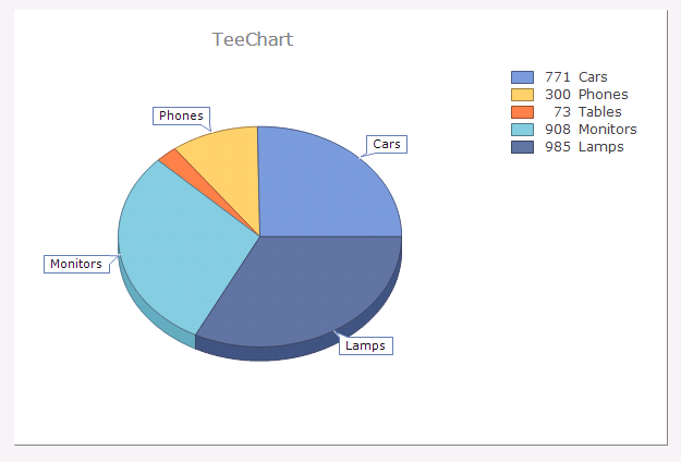

Let me try and make this a little simpler.
I start with:
I add the "Web" theme and I get:
How do I get from:
Back to:

With the latest public version TeeChart.dll, the following code:
    Pie series;
      series = new Pie(tChart1.Chart);
      series.FillSampleValues();
      tChart1.CurrentTheme = ThemeType.Web;
      series.Marks.Arrow.Visible = false;
      series.Marks.TailStyle = MarksTail.WithPointer;
gives me this:
and:
