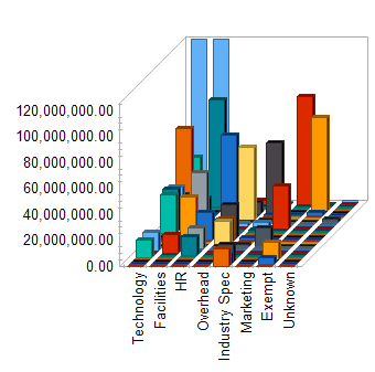

There seems to be a problem with label minimum separation when the label is not at an exact 90 or 180 degree increment.
This first example is when the labels on the bottom axis are at 90 degrees with a 1 percent minimum separation:

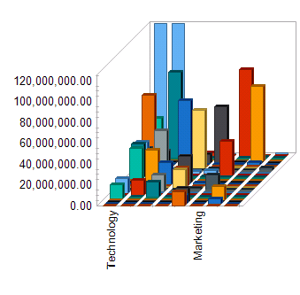

If the angle is changed by only one degree, on the next picture it is 89 degrees, the label separation is not by one percent separation but much much more:

Of course, with zero percent labels sometimes overlap and hence look horrible if the user resizes the form to a smaller size.
Is there a way to know when labels overlap and exclude them when the minimum separation is zero or is there a way to fix the one percent (or any percent value) separation so that it works appropriately when the angles are at a value of anything other than 90 and 180 degrees?
