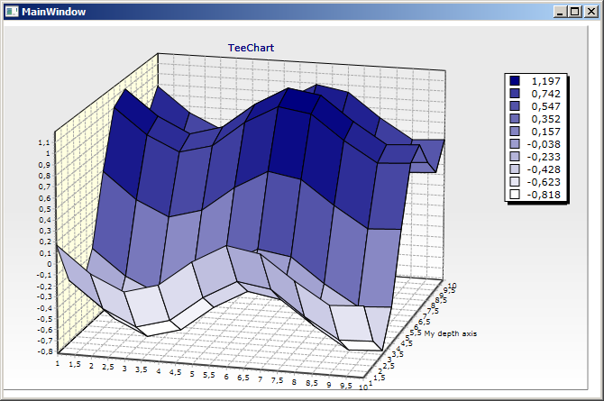

The following code seems to work fine for me here:
Surface surf1 = new Surface(tChart1.Chart);
surf1.FillSampleValues();
tChart1.Aspect.Chart3DPercent = 100;
tChart1.Aspect.Zoom = 75;
tChart1.Axes.Depth.Visible = true;
tChart1.Axes.Depth.Title.Text = "My depth axis";

Thanks, it works now. My problem was that Depth.Visible is false by default.
