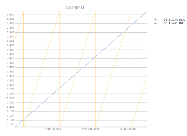

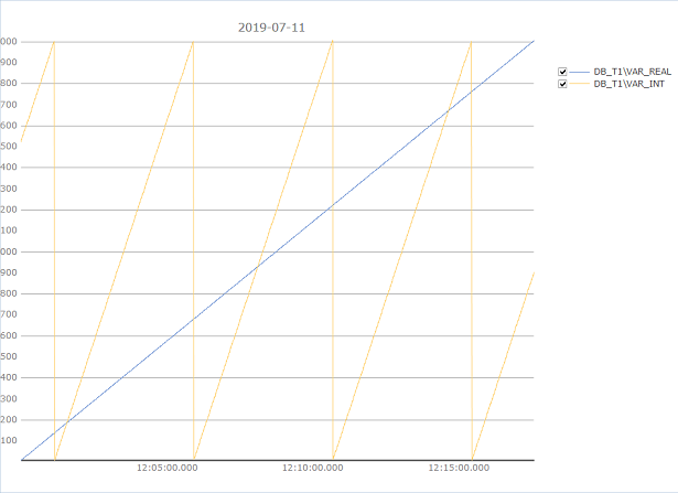

I've got an problem that I don't know how to solve.
Every Line in my Chart got an own Custom Y-Axis, but the first one uses the main Y-Axis.
I implemented a Function that hide or fade in the selected Axis.
But when a Custom Y-Axis is faded in, it doesn't get the same position like the main Axis.
So is there an option to set the same Axis-Position for the Custom Axis as for the main Axis?
Thank you for your help!!

Hello Florian,
You will need to specify a value for the LeftMargin of the Panel class to shift the Custom Axis across, e.g.
