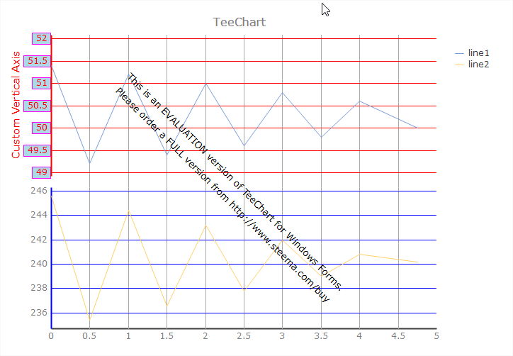

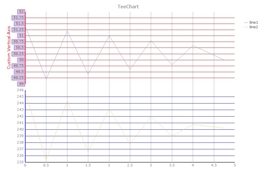

This results in the chart shown below:
I was hoping to see horizontal grid lines at the 52 and 49 label position on the upper chart Y-axis, the 246 and 235 position on the lower chart Y-axis, and vertical grid lines at the 0 and 5 position on the bottom axis.
I guess my question is there any way to get grid lines to be drawn at the start and finish of each axis, and if not, is there any other way of accomplishing the effect I am after?
Again, many thanks for your help and patience!
Best Regards
Rob

Rob W wrote:
Tue May 14, 2019 1:25 pm
Well, you could try adding the following two lines to FreqAxisAdditions() and VoltAxisAdditions():
            objAxis.MinimumOffset = 5;
            objAxis.MaximumOffset = 5;
Here this gives me the following:
