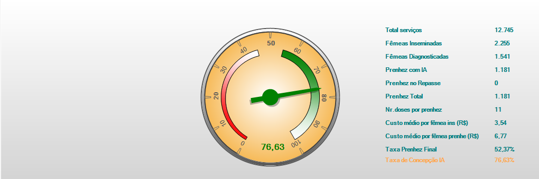

I am working on a circular gauge with an annotation.
I want the chart left aligned to use the rest of area to put some annotations.
Attached my TChart area print.
What I mean is to put the gauge at left, leaving the whole area of chart freed for notes.
Is it possible to left align the chart?

Yes, yes it is. You will be able to use the GetAxesChartRect event to define the rectangle in which you want to draw the CircularGauge series e.g.:
            tChart1.Series.Add(typeof(CircularGauge)).FillSampleValues();
            tChart1.GetAxesChartRect += TChart1_GetAxesChartRect;
        private void TChart1_GetAxesChartRect(object sender, Steema.TeeChart.GetAxesChartRectEventArgs e)
            var rect = e.AxesChartRect;
            rect.Width = 200;
            rect.X = 200;
            e.AxesChartRect = rect;
