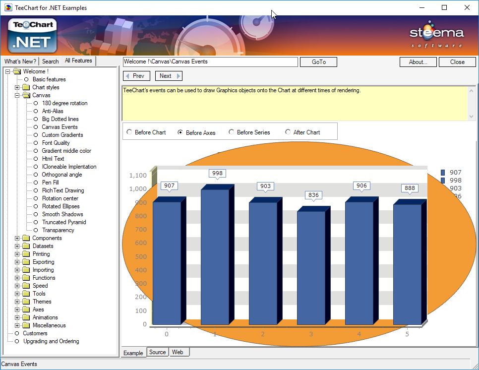

not exactly - it's primary function is for drawing custom elements onto the chart at different stages of the chart's drawing routines, as can be seen in the demo here:
given that the chart calculates the position of it's elements at the time of drawing, this means that axes properties set in the BeforeDrawAxis event may be overwritten as the chart makes its calculations at the time of drawing the axes (and not before it).
