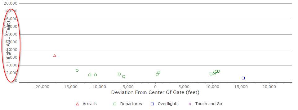

On my code I have the Y Axis Title overlapping the labels sometimes. It depends on the size of the labels.
What is the recommended way of fixing this?
I am using the latest TeeChart from nuget version 4.2018.10.27.
Y Axis Title Overlap.jpg (28.08 KiB) Viewed 8611 times

Hello -
yes, this behaviour is by design and can be modified by setting the FixedLabelSize property to false, as in the following example:
      tChart1.Axes.Left.Title.Text = "YAxis Title";
      tChart1.Axes.Left.Title.Angle = 90;
      int count = tChart1[0].Count;
      tChart1[0].Clear();
      Random rnd = new Random();
      for (int i = 0; i < count; i++)
        tChart1[0].Add(rnd.Next(100000, 1000000));
      //tChart1.Axes.Left.FixedLabelSize = false;

Post by Tim Yen » Fri Nov 16, 2018 2:21 am
Thank you it fixed it. :D
