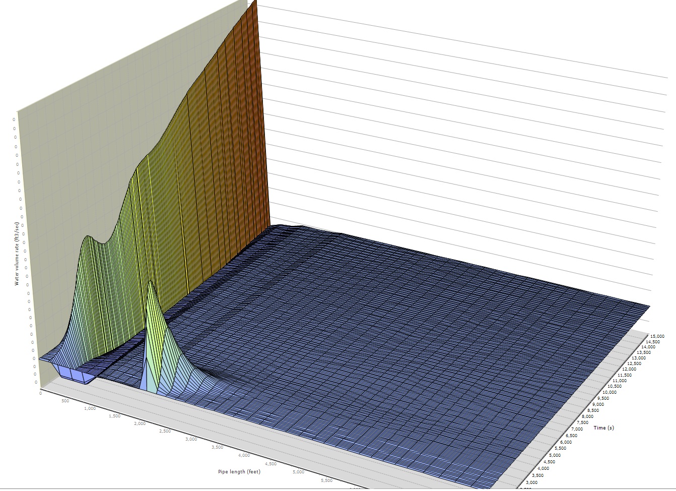

A screenshot is included to demonstrate the actual data.

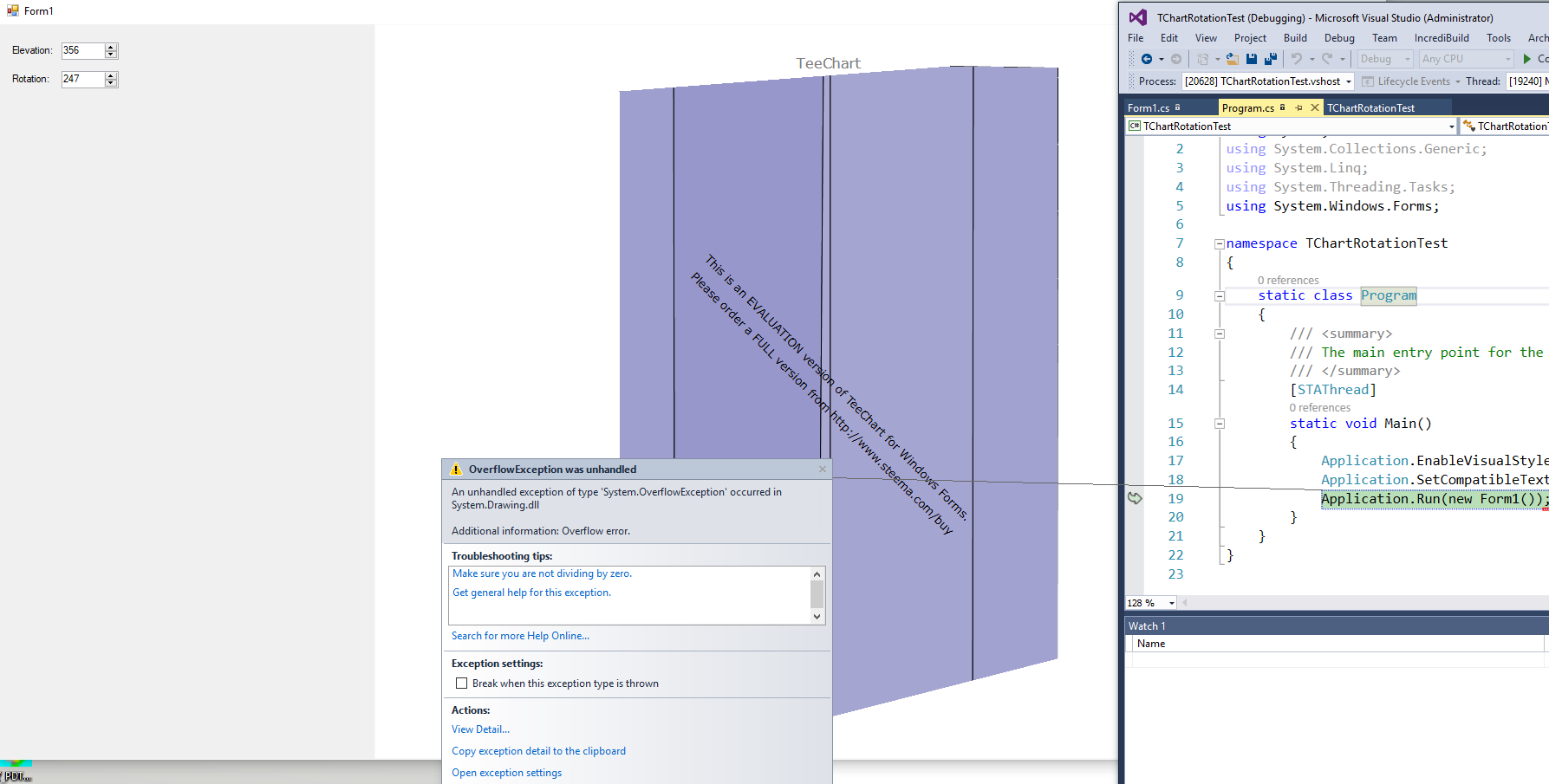

Sorry for the delay as I have been experiencing issues (on my side) updating my actual code to test the new dll.
I have tested the evaluation dll on the sample code in my previous post.
There is a clear improvement (with 4.2018.9.25) in successive zoom and rotate rendering of the mesh.
I am unable to re-create the mesh tearing (found in 4.1.2018.5046)
However I am still able to generate the overflow error.

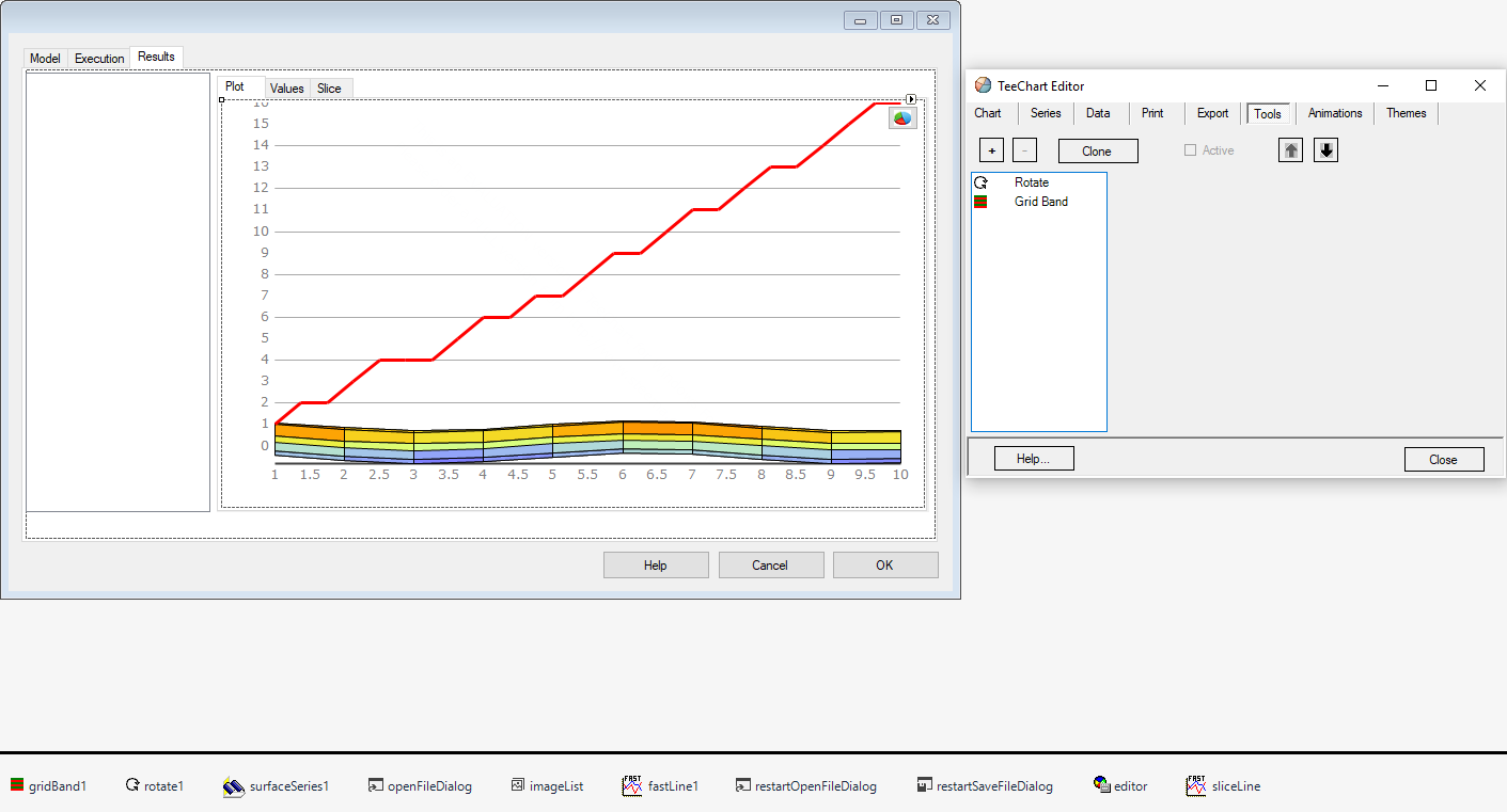

I have also tested our actual application with real data (see the screenshot in last post) and both the Mesh tearing and overflow error still exist ( to a lesser extent).
I am using a gridband, slice line, fast line and rotate tools ( something is still asking for version 4.1.2018.5046) when I display my plot ( I can find no trace of a version reference in my project, license etc)

Yes I have tried deleting the license file contents and additional version information entries in my VS project files.
I run my application I see the evaluation banner on the 2D plot which leads me to conclude I have built with the evaluation version.
I display the 3D surface plot and a failed to read the assembly 4.1.2018.5046 but I can continue and the 3D plot is displayed
I perform a series of zoom/rotate actions as before ( there is tear up and the asset appears)

Here are the results using the BeforeDraw event up to the Zoom/Rotate overflow.
Hope this helps.
kindest regards
Test data
windows\dwm\dwmapi\attribute.cpp(92)\dwmapi.dll!71833CF4: (caller: 718890ED) ReturnHr(52) tid(1234) 80070006 The handle is invalid.
Rotation 16 Elevation 276 Zoom 100
Rotation 345 Elevation 280 Zoom 100

An unhandled exception of type 'System.OverflowException' occurred in System.Drawing.dll
Additional information: Overflow error.
c.f. with Actual data
windows\dwm\dwmapi\attribute.cpp(92)\dwmapi.dll!71833CF4: (caller: 718890ED) ReturnHr(115) tid(e2c) 80070006 The handle is invalid.
Rotation 255 Elevation 360 Zoom 66
